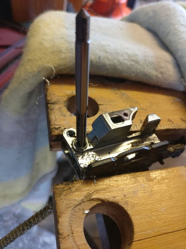

Geeba 0 Posted March 20, 2017 Just for information, people with broken lifters, this solution does work.... This was a test run on a snapped part.. Centre punch (carefully) the centre of the snapped part and then pilot drill a hole, move to a larger drill to accommodate your tap, very carefully again tap a suitable thread in the monkey metal part. I did this without stripping the sunroof down on the actual one I used, but if you have access to a pillar drill and stripped it down it would probably be easier.. I then ground the screw head down leaving barely a millimetre of metal to hold the lifter in place, you could drill the thread of the screw and insert a small pin or spigot to fully replicate the original, but I just left a small amount of metal to hold the lifter on, then dabbed a bit of silver paint on it, you would never notice it unless you were seriously looking for it. Remember the lifter without the spigot will fall too low and foul on the frame of the sunroof so ensure you re-fit the trim ASAP! or watch very carefully when you are sliding it back or it will jam and snap it! Quote Share this post Link to post Share on other sites
