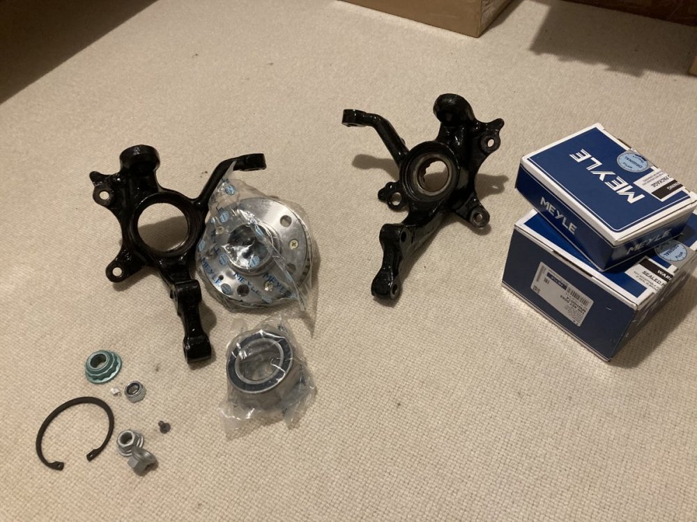

The only crusty bit left on my car (ok not really including the ABS Unit )is the hubs - they look so crusty its gross so wire wheeled these spare vr hubs/ krust then black caliper heat paint . got a hub and bearing kit- after removing the old abs sensors in the spare hubs I purchased 2 new Bosch ones as they just fell apart - were reasonable at £15.00 a side compared to vags £70 - £80 a side. Of course left the old bearings in for Vince to pull out ha. The hub and abs sensor ring was very good value.

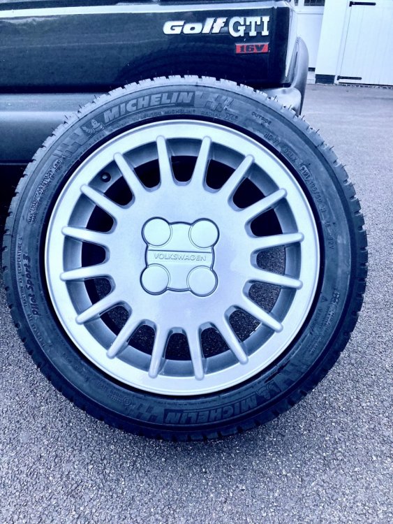

Looking forward to getting these on the valver .
x4 Michelin pilot sports for £270 went for 195 50 15 - great price for my favourite brand tyre . Only 1 weight on alloy for balancing - very straight for  30 year old alloys .

I absolutely love the Sebrings, perhaps because of the Rallye.

Will do mate have spacers on the car and 30 mm drop so will sit handsomely I hope.

Looks amazing! Sebring are my favourite wheels on a MK2 and Michelin tyres are top, great combo mate!

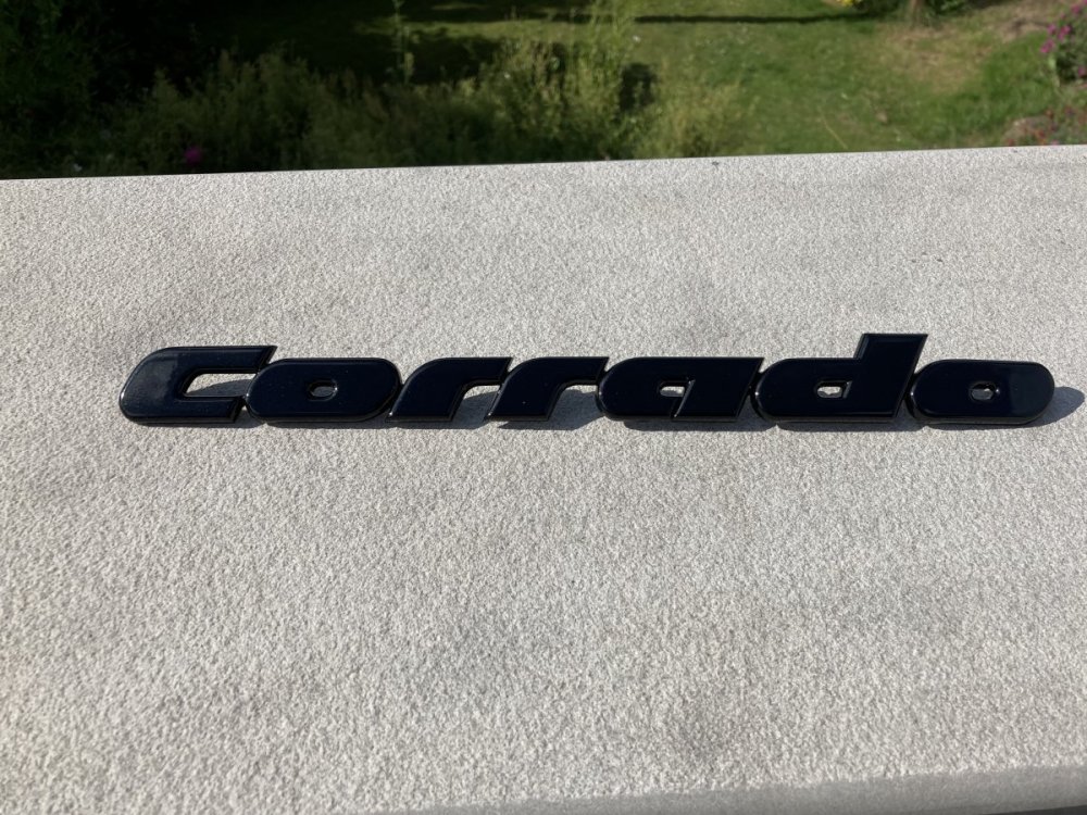

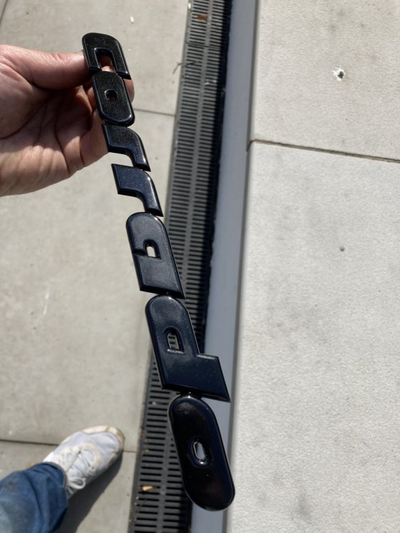

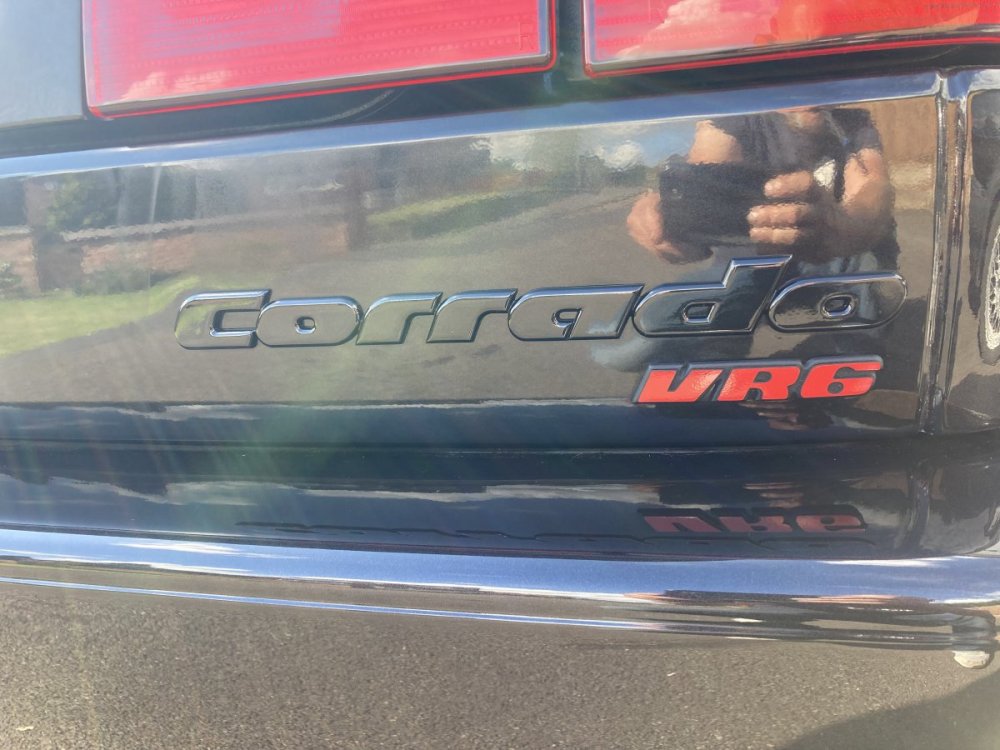

Bit of  colour coding today - rich in flake is Black Magic . Halfords Vw black Pearl matched well and undercoat plastic primer finished of with lacquer. Plenty of practice im getting ok with a rattle can .

That looks good, think I might have a go at my old one and see how it goes. The early cars had them colour matched and I preferred that to the chrome.

I did that to my MK2 twenty odd years ago, stole the idea from B3 Passat, looks so much cleaner
From what I can see the early corrado came colour matched on script badge - you can only buy repo silver badges that are I cant think of the name has the matt glazed effect- so best thing to do is colour match the black matt oe badges that you can still buy from VW.
Im not that patient so im like.
3m alcohol body panel clean product.
1 hour for primer to dry x 2 light coats
Top coat x 3 10 minutes each coat apart
Laquer 10 minutes later x 3 coats 10 minutes apart.
All above light coats and only sprayed in sunny weather 20 degrees plus (not over 25 ) for good cure. Each coat touch dry before next application.
I could wet sand the lacquer on the script but its a good enough finish as it is for me .
