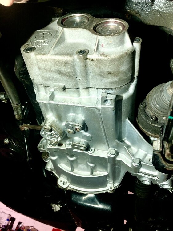

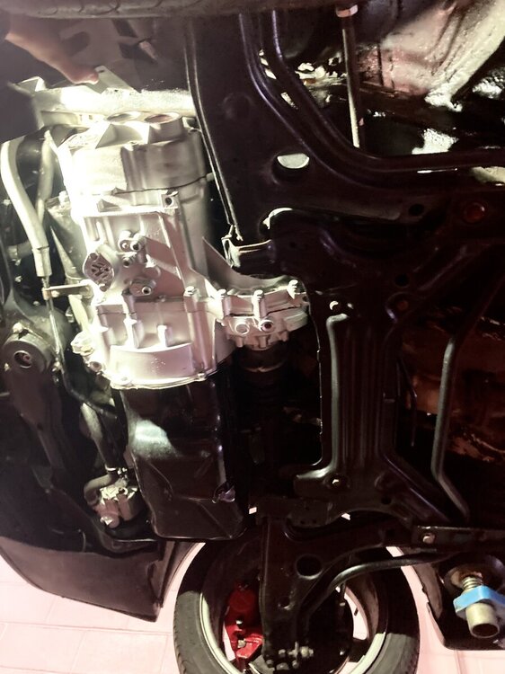

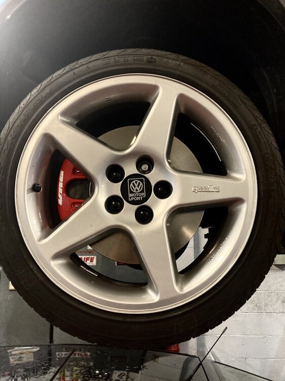

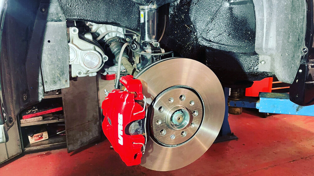

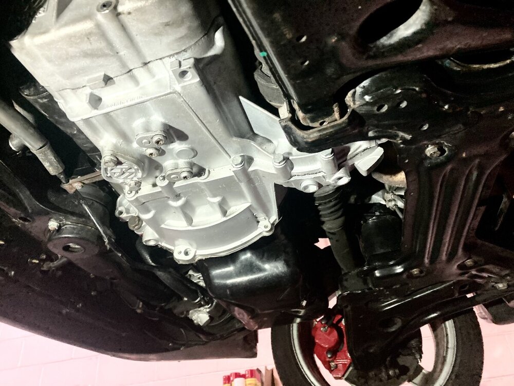

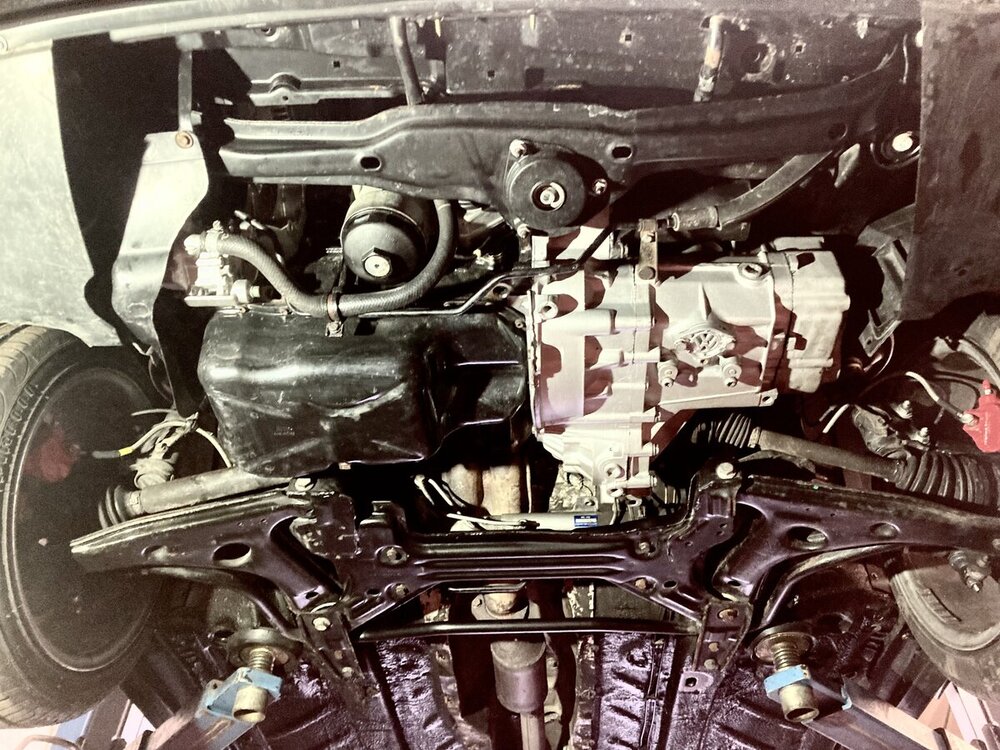

Keyo 49 Posted November 24, 2021 Getting very close now guys to the finishing line . 288mm upgrade . Quote Share this post Link to post Share on other sites

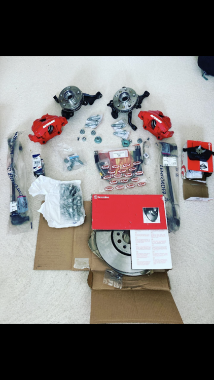

_Matt_ 32 Posted November 24, 2021 Looking nice. What's the brakeline you went for - is it a braided version? I need a couple of the same fo mine. Does it join all the back at the hard line? Quote Share this post Link to post Share on other sites
Keyo 49 Posted November 24, 2021 On 11/24/2021 at 10:37 AM, MJA said: Looking nice. What's the brakeline you went for - is it a braided version? I need a couple of the same fo mine. Does it join all the back at the hard line? https://www.ebay.co.uk/itm/202562895141 Quote Share this post Link to post Share on other sites
ABV-VR6 12 Posted November 24, 2021 Lovely sight! Nice to see the 6th gear box making a peek-a-boo. Can't wait to hear about it! Cheers Quote Share this post Link to post Share on other sites
Keyo 49 Posted November 24, 2021 On 11/24/2021 at 4:53 PM, ABV-VR6 said: Lovely sight! Nice to see the 6th gear box making a peek-a-boo. Can't wait to hear about it! Cheers Very observant mate . Quote Share this post Link to post Share on other sites
seanl82 23 Posted November 24, 2021 Get those drive shafts powder coated, they're letting the side down! 😆 Quote Share this post Link to post Share on other sites
Keyo 49 Posted November 24, 2021 (edited) On 11/24/2021 at 6:07 PM, seanl82 said: Get those drive shafts powder coated, they're letting the side down! 😆 I know I thought that when I saw the picture - it’s had new lemforder. Track rods to so it is seriously letting down the picture - not to rusty to be be fair just need a good clean . Edited November 24, 2021 by Keyo Quote Share this post Link to post Share on other sites

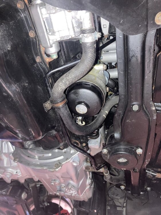

Cressa 45 Posted November 27, 2021 All lovely, I'm not too jealous. Be nice to put it on a track or a rolling road. But you have got to change the oil sump and bolts for shiny ones too 😊 Quote Share this post Link to post Share on other sites
Keyo 49 Posted November 27, 2021 On 11/27/2021 at 1:55 PM, Cressa said: All lovely, I'm not too jealous. Be nice to put it on a track or a rolling road. But you have got to change the oil sump and bolts for shiny ones too 😊 I did attempt that and got some off VW International but they were too long- genuine vag ones to . Quote Share this post Link to post Share on other sites
seanl82 23 Posted November 27, 2021 On 11/27/2021 at 1:57 PM, Keyo said: I did attempt that and got some off VW International but they were too long- genuine vag ones to . There are 2 types/sizes of bolts. If you have an earlier fibre gasket it uses shorter bolts. For the later type rubber gasket, it's thicker so uses longer bolts. Can't remember the sizes of each but I'm sure you'll find them on Zap7VW. 😉 Quote Share this post Link to post Share on other sites
Keyo 49 Posted November 27, 2021 On 11/27/2021 at 4:45 PM, seanl82 said: There are 2 types/sizes of bolts. If you have an earlier fibre gasket it uses shorter bolts. For the later type rubber gasket, it's thicker so uses longer bolts. Can't remember the sizes of each but I'm sure you'll find them on Zap7VW. 😉 Its actually tactical to taunt you and cressa car ocd lol. Quote Share this post Link to post Share on other sites

seanl82 23 Posted November 27, 2021 On 11/27/2021 at 6:20 PM, Keyo said: Its actually tactical to taunt you and cressa car ocd lol. Haha, just seems counter productive and much more expensive in the long run with the drive shafts, as they would have been removed to fit the gearbox and hubs anyway. Same with your engine rebuild, the sump would have been off with a new gasket fitted, so seems a shame not to have had it powder coated and new bolts put on is all. I understand you've got to stop somewhere though mate, costs spiral as it is without wanting to change every single component whilst you're there. Everything else just seems so shiny in comparison though! Lol. Quote Share this post Link to post Share on other sites
seanl82 23 Posted November 27, 2021 (edited) If the CVs are good, could just mask them up and rub down/wire wheel the shafts and spray some hammerite on them maybe? Same with sump maybe, and just change bolts one at a time torquing up to spec (25nm iirc) to save the hassle of dropping it with new oil and changing the gasket as well. 👍 Edited November 27, 2021 by seanl82 Quote Share this post Link to post Share on other sites

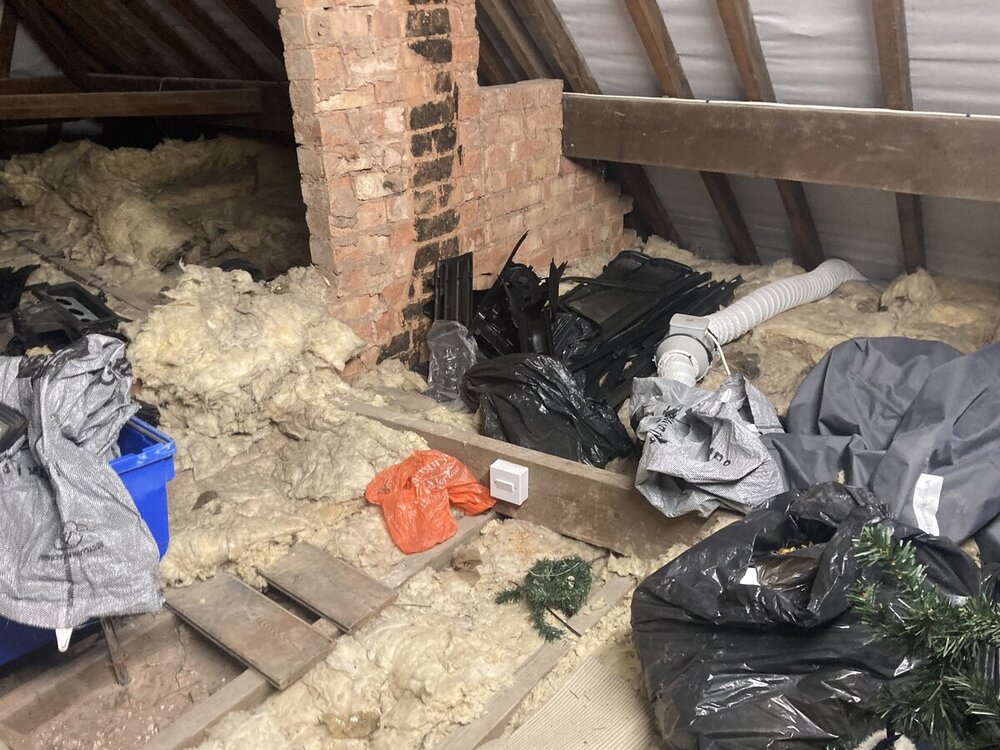

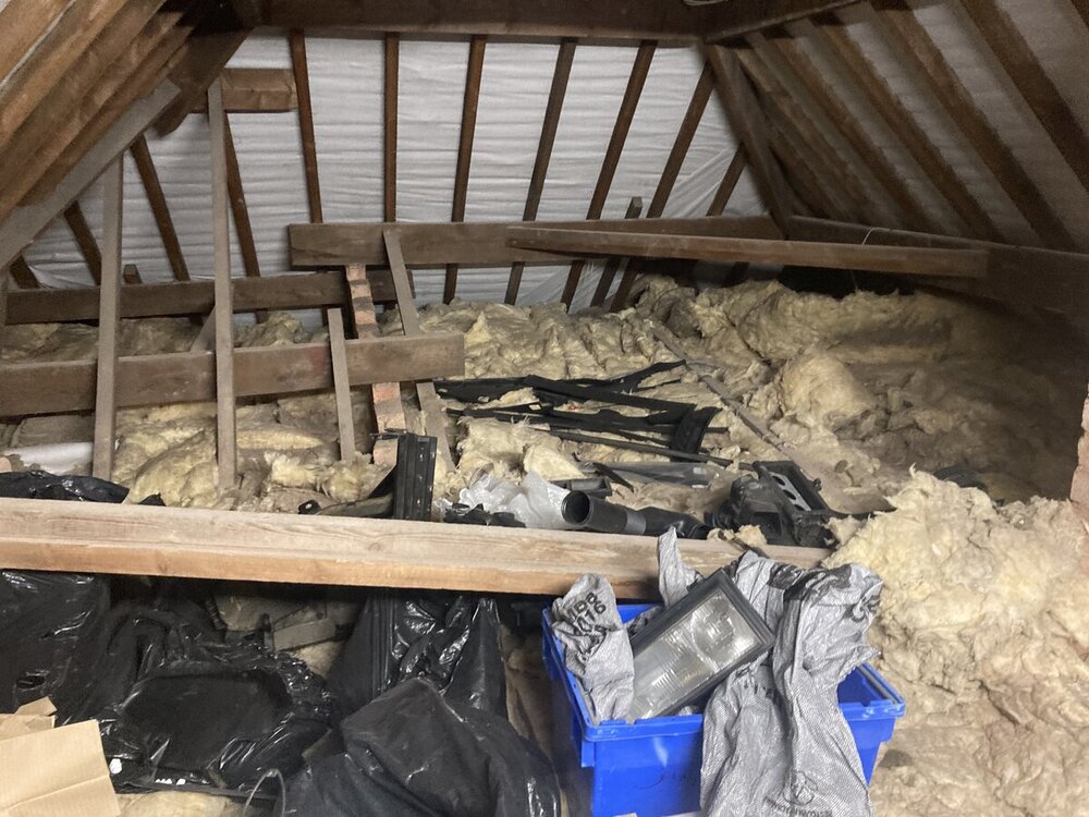

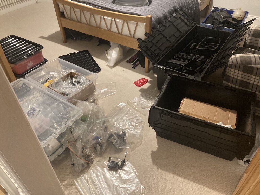

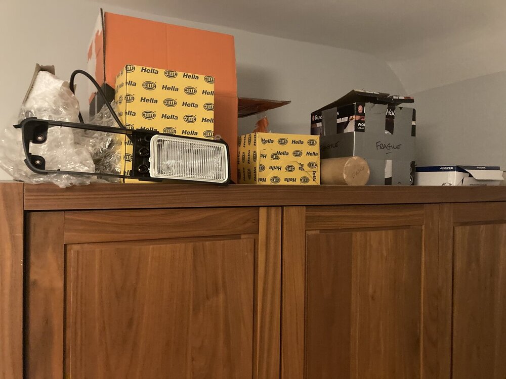

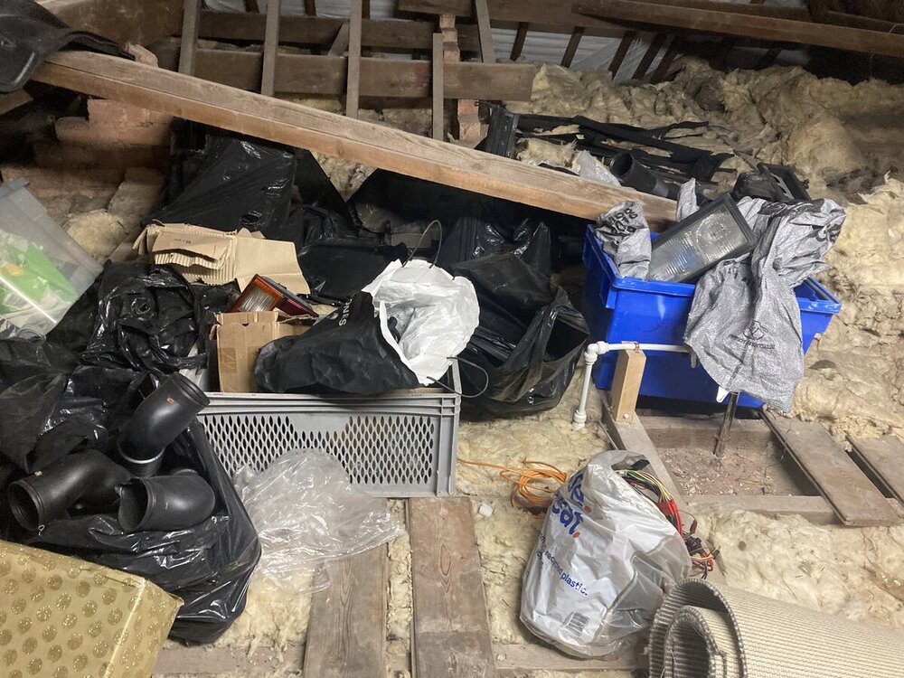

Keyo 49 Posted November 27, 2021 (edited) On 11/27/2021 at 7:12 PM, seanl82 said: If the CVs are good, could just mask them up and rub down/wire wheel the shafts and spray some hammerite on them maybe? Same with sump maybe, and just change bolts one at a time torquing up to spec (25nm iirc) to save the hassle of dropping it with new oil and changing the gasket as well. 👍 Yeah I might do the bolts one at a time that works - pictures above I cleaned the drive shaft whilst there and in good nick👍 My next project is boxing all my part hoards into boxes this is just the start - tote boxes are very handy . Not even touched the loft yet it’s a nightmare but you have to have spares to keep 3 classic Vw going and I’ve collected a fair few garage clear outs in the past mostly when folks are moving house . Edited November 27, 2021 by Keyo Quote Share this post Link to post Share on other sites

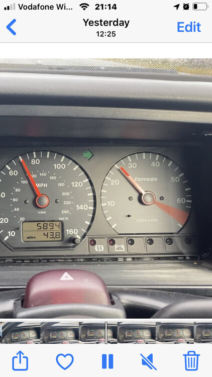

ABV-VR6 12 Posted November 28, 2021 Quite a collection mate! Very nice! Do you feel a "big" difference between the 5th (0.79) and the 6th (0.75)gear? Must have been a great feeling the first time you shifted it into 6th!! I should do lime you and start writing things down as I forgot some already! Cheers Quote Share this post Link to post Share on other sites
Keyo 49 Posted November 28, 2021 (edited) On 11/28/2021 at 7:09 PM, ABV-VR6 said: Quite a collection mate! Very nice! Do you feel a "big" difference between the 5th (0.79) and the 6th (0.75)gear? Must have been a great feeling the first time you shifted it into 6th!! I should do lime you and start writing things down as I forgot some already! Cheers Yes mate it pulls very strong in the high gears now - the car feels like a proper autobahn stomper now with the semi helicut top gears feels more torque for sure. Cant wait for summer a stock vr would stand no chance against this car now on the motorway great upgrade totally recommend. Top picture 6th at 70 mph Bottom picture 5th 70 mph. . Edited November 28, 2021 by Keyo Quote Share this post Link to post Share on other sites
