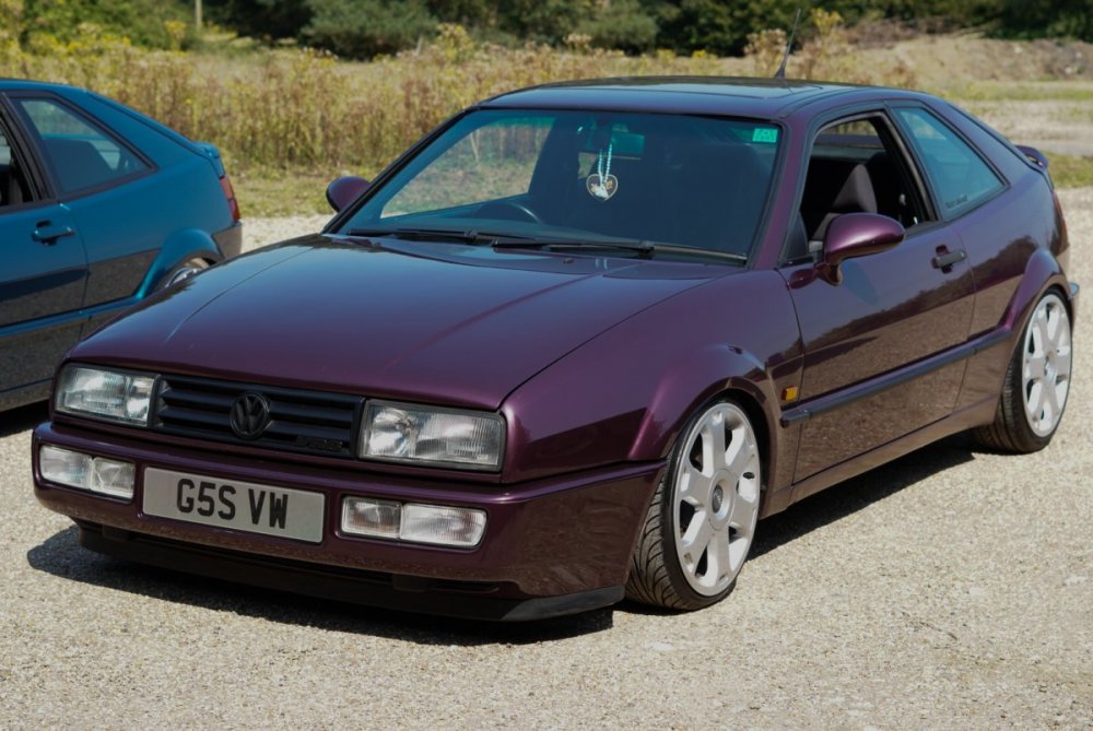

Grande GTi 11 Posted April 28, 2020 (edited) So first and Foremost Hello All. Corrado journey started in 2018 for me, I've had a couple of my friends badgering me and tellin my how good they were and finally for personal reason i felt i best give it a shot, It started. First Corrado I had was a 1994 VR6 2.9 130k, leather drove like a dream but i wasnt sold on it as it needed paint and the previous owner had waxoiled all over the bolts etc. A friend of mine a guy thats very well known amoungst the Corrado Family Sukh (Westside SLC VRT) offered me his current Corrado not the VRT as that was sold years ago, but a better spec than my last so i bought this Mileage is in the 200k but the chains have been done, paints Tidy, currently on Stillstatic H&R Coilovers, Recaro Elec Seats and few more bit. I've been working through my list to get it as close to as possible. Edited April 28, 2020 by Grande GTi Quote Share this post Link to post Share on other sites

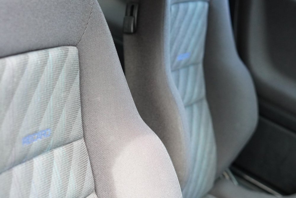

Keyo 47 Posted April 28, 2020 Nice looking motor and welcome to the forum. Like your early recaro seats- was that stock leathers in that you had before? Think you have also got some speedline corse - are they 17 ? Quote Share this post Link to post Share on other sites

Grande GTi 11 Posted April 29, 2020 15 hours ago, Keyo said: Nice looking motor and welcome to the forum. Like your early recaro seats- was that stock leathers in that you had before? Think you have also got some speedline corse - are they 17 ? Thank you very much THe old one yes had factory leather but to be completely honest I am not a fan of leather on the whole tbh so the Change to the cloth interior was perfect. thats right they were speedlines they went with the car, a friend of ours bought it and seems to be making great progress with it 14 hours ago, ChrisL said: Really nice corrado this and looks even better from the side Think it was Zak's old VR Indeed it is Zaks old car, He really done a great job maintaining it, and thankfully I now will try and keep it to its former glory and hopefully tastefully change a few things along the way I spent a good hour or so going through his build thread last night its actually quite good to know that a previous owner was as passionate about it as I am. 13 hours ago, fla said: Yes certainly looks like it. Great car, had 263s and was a really good drive It really is a good drive, the friend that i bought it off took it to Austria last year. Thankfully Ive got a couple of other cars too but ill be honest I would much rather drive the Rado. Quote Share this post Link to post Share on other sites

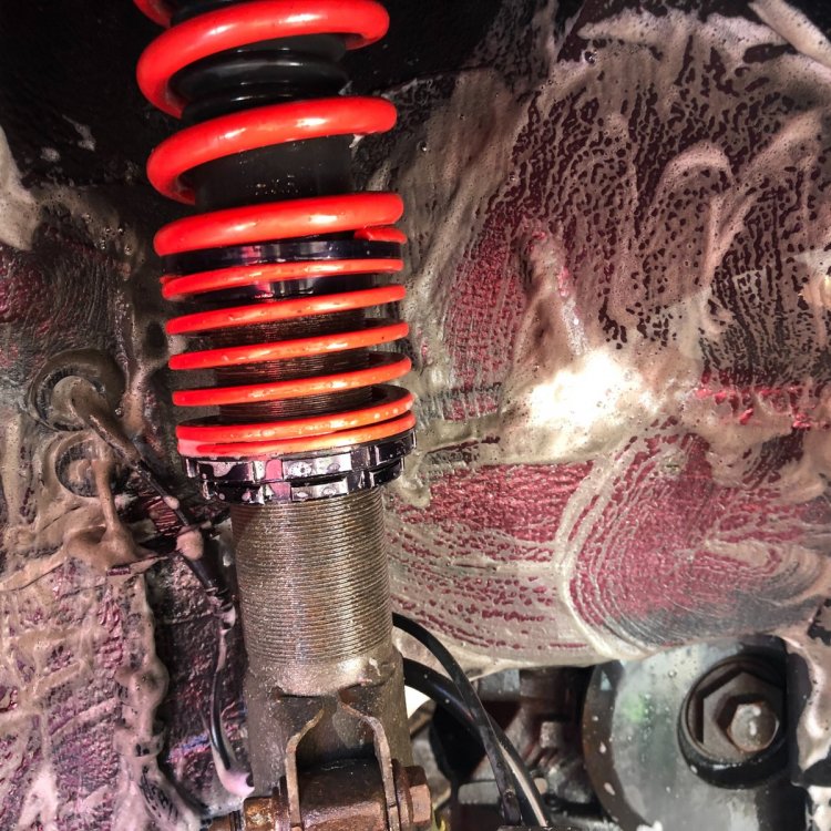

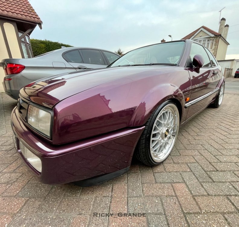

Grande GTi 11 Posted April 29, 2020 (edited) During Lockdown it only made sence to give the Corrado some care So wheels off APC Cleaned up pretty well Followed by a Snowfoam, Soap Down, Clay barred, Polished then Sealed. Pretty Happy how it turned out. Car is currently on H&R Ultralow Coilovers which ride alot better than the last APs which were on the old Corrado. Edited April 29, 2020 by Grande GTi Quote Share this post Link to post Share on other sites

ChrisL 20 Posted April 29, 2020 Lovely car mate, I’ve been following your pics on Instagram. its been on some great wheels and especially liked it on the RC’s and CH’s but those S3 alloys really work Quote Share this post Link to post Share on other sites

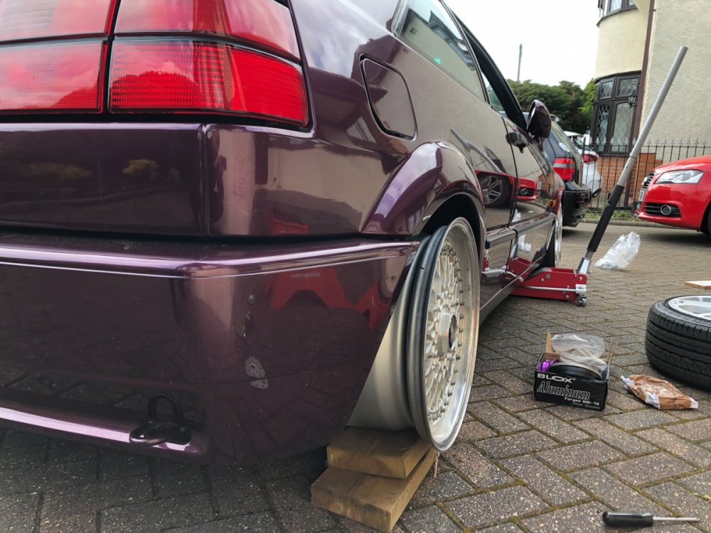

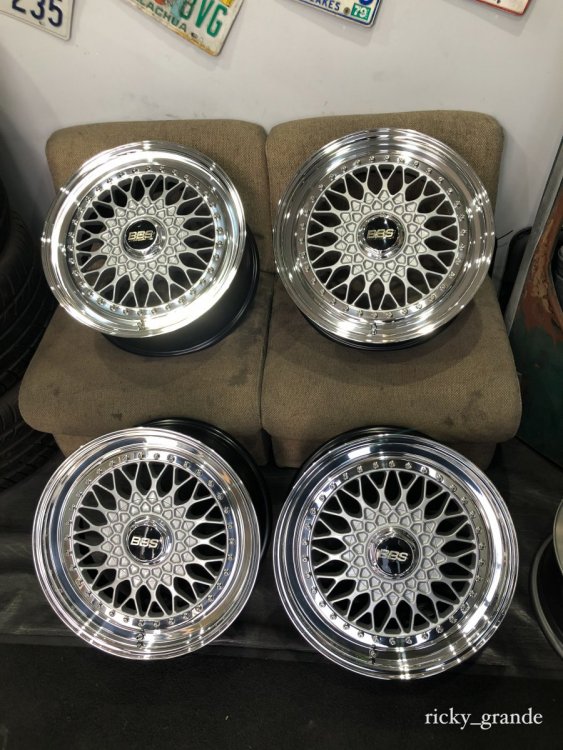

Grande GTi 11 Posted April 30, 2020 23 hours ago, Simeon said: Looks fantastic Thank you very much mate 21 hours ago, ChrisL said: Lovely car mate, I’ve been following your pics on Instagram. its been on some great wheels and especially liked it on the RC’s and CH’s but those S3 alloys really work oh excellent nice one, only this morning DPD dropped off my new wheels, bought a set of BBS RS 17 7x7.5, 8.5 after a cheeky test fit seems the 8.5 are hitting on the coil springs, i can clear it using a 15mm spacer but then its changing the image in my head, so going to order a a pair of 1/2 smaller barrels which will solve the problem. The S3 will probably be up for sale soon too. 16 hours ago, James. said: C’est magnifique. And Porsche wing mirrors as well. What are the other jobs ? (doesn’t seem much from this angle). Tres bon. Thank you James its go a few things that need doing well the list on my phone is massive but i wont go there,, a few things are Sunroof needs changing, so organised one from Chris Ferry just gotta drive up to him once covid 19 is done, Get a spoiler as the current one goes up in stages, Fit a set of 312 discs as the current callipers are mk4 ones and disc are 288 corrado ones, Change inner centre dash panel, Stick a new Stereo in.Its got a few other odd jobs but most is that i. just being picky. Most importantly fit its new bumper 🙂 Quote Share this post Link to post Share on other sites

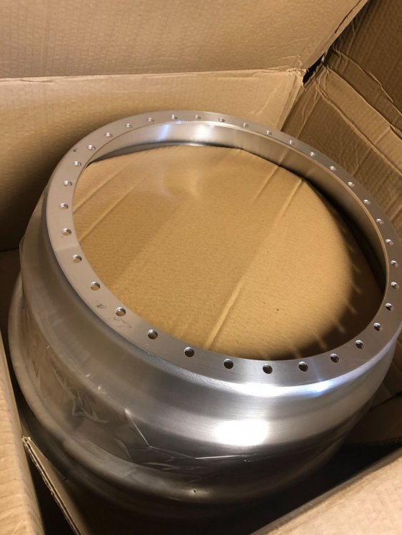

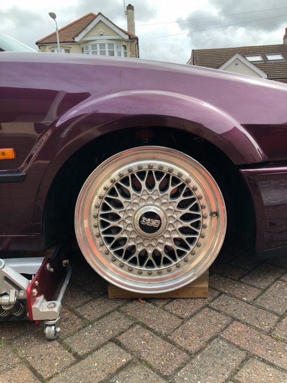

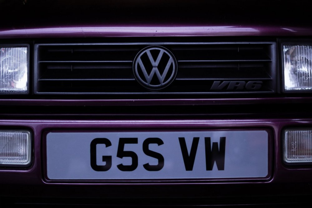

Grande GTi 11 Posted May 22, 2020 Living in Essex and not having a plate just creates unnecessary head ache so thankfully got a new-another had it painted and put a front plate back on the car, whilist I had the bumper We saw that the Looms had heavily corroded and at some point in its life must have had issues which damaged the front headlight loom so we made a new loom up. Also saw another set of 17" BBS RS on line so bought them for the corrado, 7.5 and 8.5, had a slight issue that the back of the barrels we sitting inside the spring which resulted in my buying slightly smaller barrels and reducing them down to 8j on the rear. Managed to source the New barrels through SRR Hardware and genuinely couldn't recommend them enough Ordered monday here next day so a win win 🙂 Wheels are now with Wheel shop for them to be polished up and rebuilt and will be on soon all being well. Quote Share this post Link to post Share on other sites

Grande GTi 11 Posted November 28, 2020 Not allot to report in respect of look and any real upgrades, more so of trying to sort out the gremlins in the car. Had an issue with the fuel pump after a long drive it would hum for a little while so managed to get a replacement one sorted so problem solved, but have had an idling issue for some time, and a random misfire. So today managed to eliminate what we think it is, quite confident its the ISV, i did replace it as well as the vacuum pipe on the TB, Throttle position sensor turns out the new ISV was faulty too, so trying to source one at the moment. Fitted a genuine coil pack and ht leads to the car and the misfire is for the moment no more. But got the wheels back from RustyRims and has done a cracking job. 1 Quote Share this post Link to post Share on other sites

Cressa 44 Posted November 29, 2020 Ooo those BBS are super shiny, very nice. I would just hang them on a wall in the house so I could look at them. And they would stay clean. Quote Share this post Link to post Share on other sites

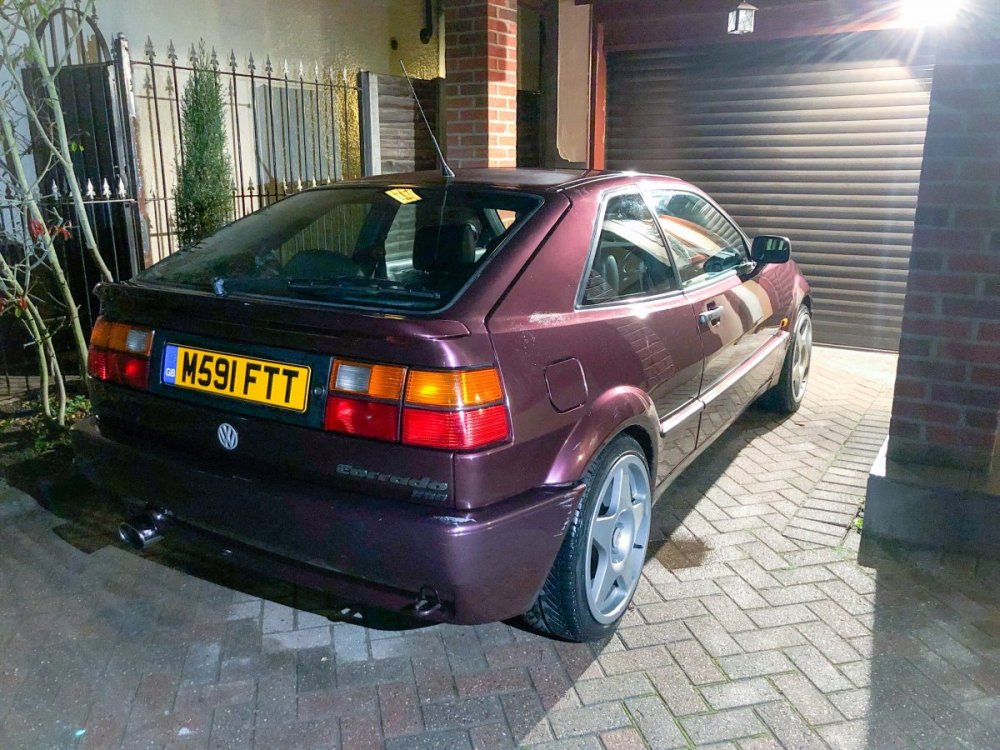

Grande GTi 11 Posted September 10, 2021 Finally after months of agg the car finally holds idle and runs well so thought itd be good to get some pics Quote Share this post Link to post Share on other sites
