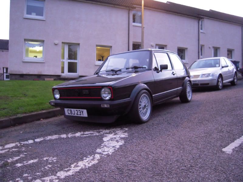

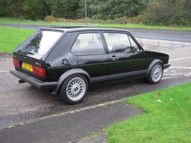

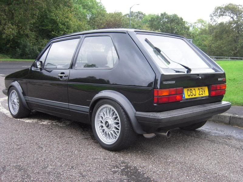

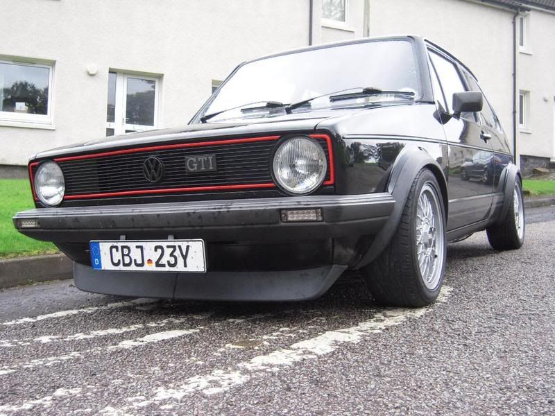

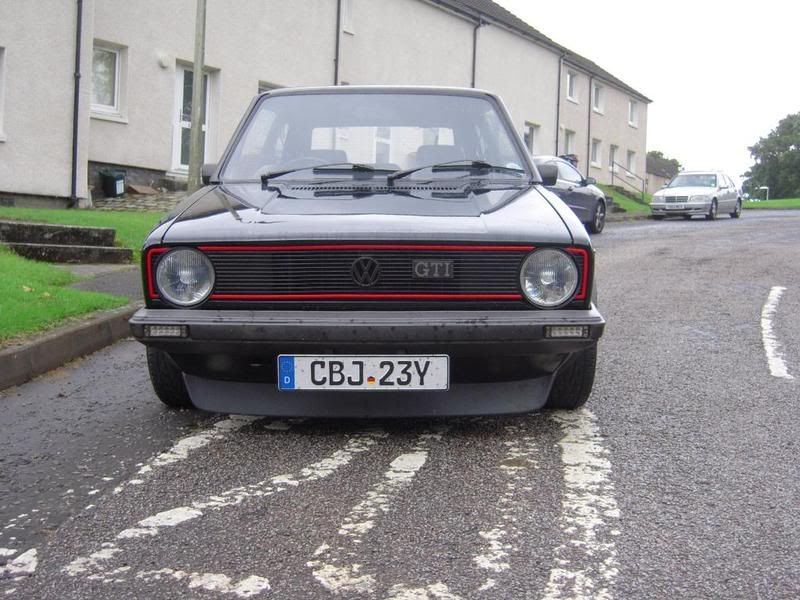

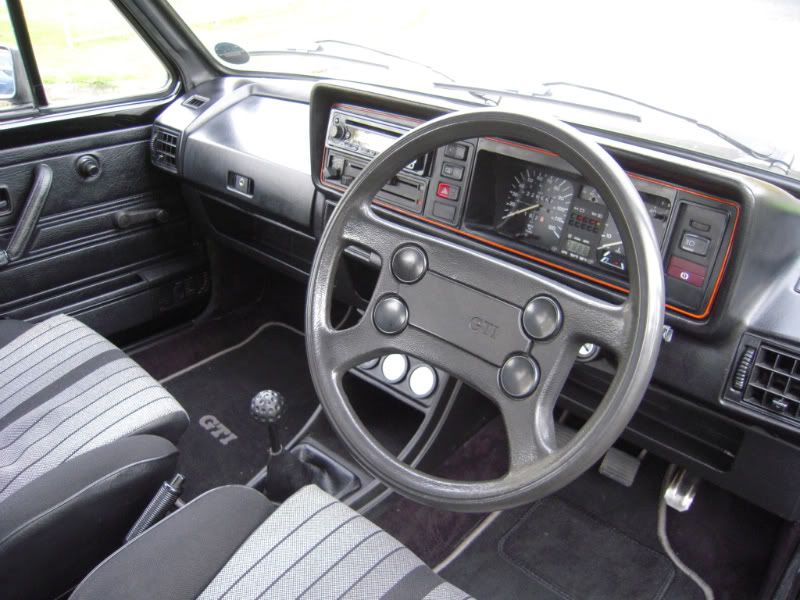

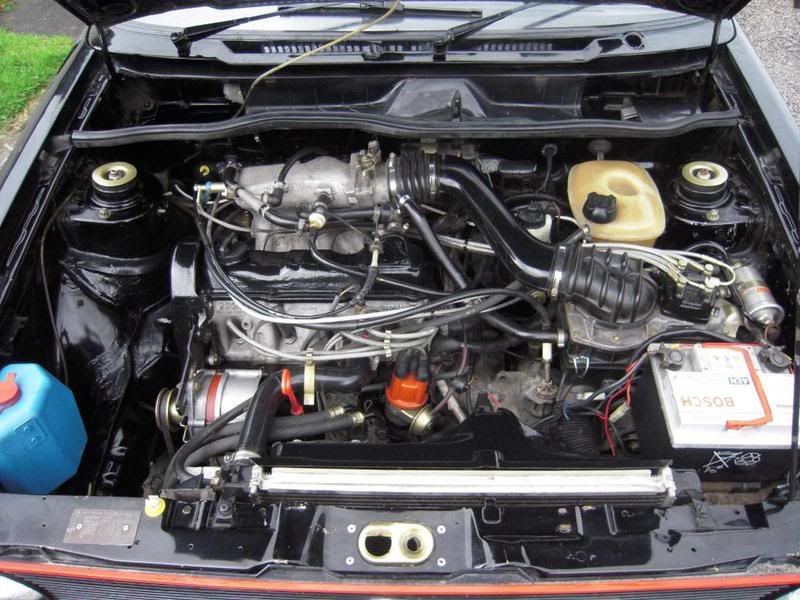

Goldie 2 Posted September 27, 2009 Ok, the Corrado has left the building... After a lot of hunting though i havce found this little baby. Its a Mk1 GTI, non sunroof with a whole host of nice little upgrades that im enjoying and have a list of to dos that is quite long.. Basics Full windows out respray in 2005 Engine rebuild including TSR 1.9 conversion, ligtened and balanced bottom end, ported head, 4 branch, stainless exhaust BBS RZ (Rado G60) rims, refurbed with Uniroyal rainsports Mk2 16v brake Servo and front set up Original and very tidy interior Lowered on not the best coilies but theyll do for now Its had pretty much all bits that will go changed so its th basis for a good project, its no minter but shes good.. And one with the Bora in the background Quote Share this post Link to post Share on other sites
KADVR6 0 Posted September 27, 2009 nice mk1 mate, in the 2nd pic are you seeing if the baby seat will fit ok in it :lol: Quote Share this post Link to post Share on other sites
CazzaVR 0 Posted September 27, 2009 That is really, really nice! Good find! How quick is it? Quote Share this post Link to post Share on other sites

Goldie 2 Posted September 27, 2009 Baby seat is in the Bora Karl..... :D Its quick Andy, ive got a dyno printout at 130bhp but it would smoke my old Mk2, it doesnt like going much over a ton though, handling is simply brilliant.. Quote Share this post Link to post Share on other sites

Goldie 2 Posted September 27, 2009 Thats an interesting stat, it picks up really well, ok some of it is due to the feel of the car but the speedo needle moves up very quickly. Now where near the mid range grunt of a VR though. Its a very dated car which i guessis the attraction, the grab handle on the B pillars, the very strange heating set up, very heavy steering and quartlight windows to name but a few just add to the character.. Over the next couple of days im planning on raising her up a bit, i want it low but its a bit too much for me at the moment, im going to give it a full service tomorrow and then its major cleaning time to see exactly what ive got so its all wheels off, bumpers off, arch trims off. The paintwork is very good but as we all know black doesnt hide a thing, a good polish will bring it up well but there are a few areas that will need some attention but nothing where rust has taken hold. Theres a few defects to deal with, usual MFA, pathetic wiper motor, headlights not playing will keep me busy.. Ill put some more pictures up once its has the full treatment.. Quote Share this post Link to post Share on other sites

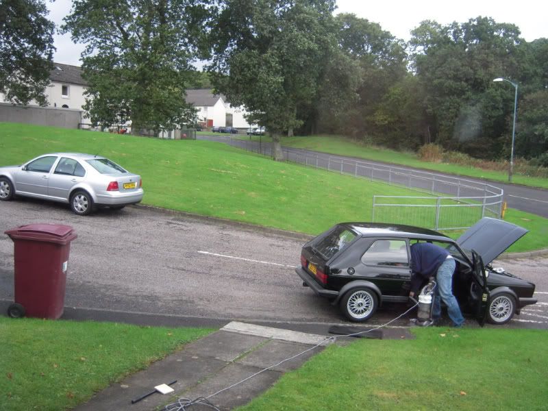

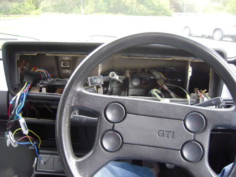

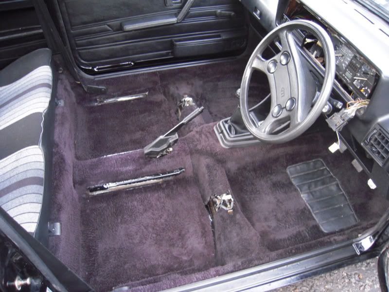

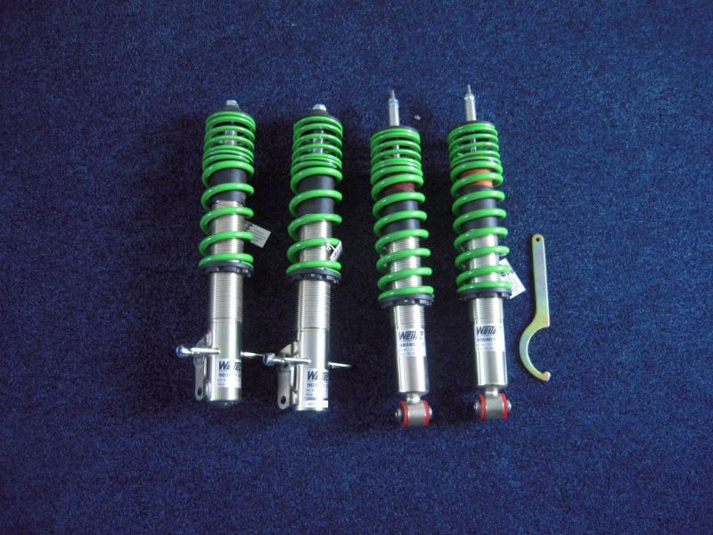

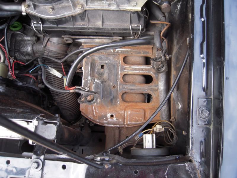

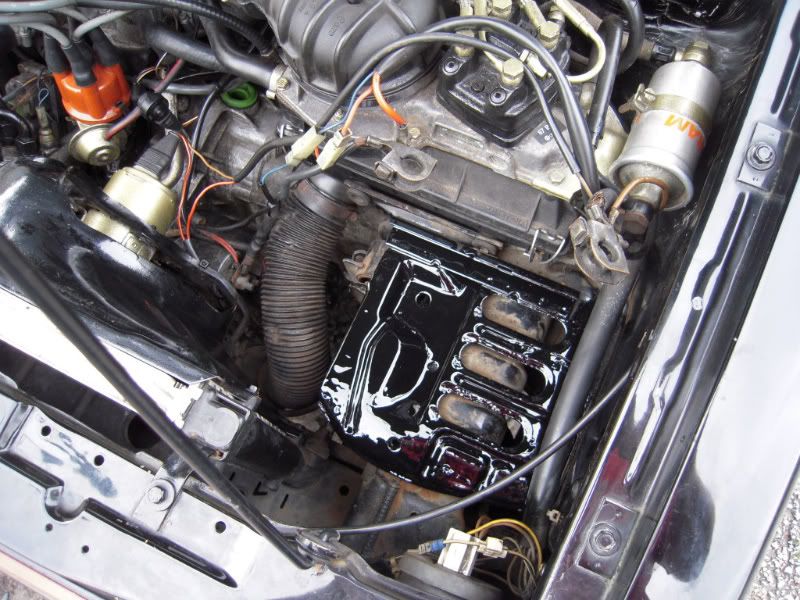

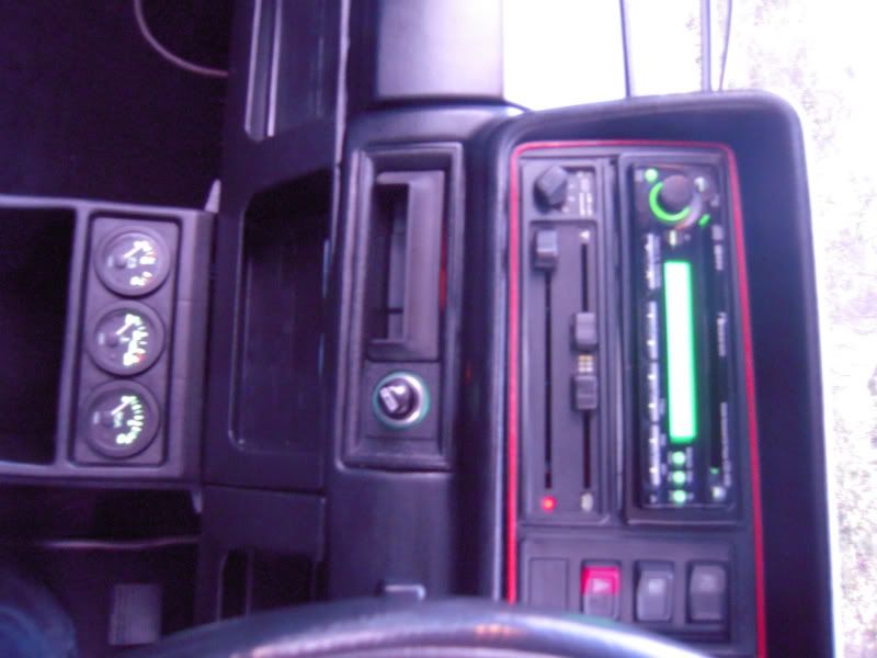

Goldie 2 Posted October 21, 2009 I thought id throw up a progress report on the Mk1: So, what have i been doing: New suspension - Weitec GT coilovers, all set up to make it stand correctly. Interior fully removed, dash wiring sorted, missing door internals sorted, carpets and seats shampood. Radio fitted, speaker wiring sorted, dash redstriped. VDO gauges installed (not finished yet). Battery tray stripped back and repainted. All arches have been off (front wings will be due a change). Lighting defetcs all fixed, it was an absolute disgrace. Full Service, coolant flush, thermostat fitted. Front indicators changed to clears, German plates binned.. To come (soon) full new fuel system as it leaks. Filler neck already done, all braided lines, new pump and accumulator coming up. new rubber upfront, going narrower. Bigger picture: All suspension parts off for blast, coat, rear disc conversion. Im enjoying this car greatly, ok i hardly drived it as the fuel leak has put a stop to that. Its easy to work on but age makes it fiddly as time takes its toll and hurrendous previous work needs put right.. Pictures: Quote Share this post Link to post Share on other sites
