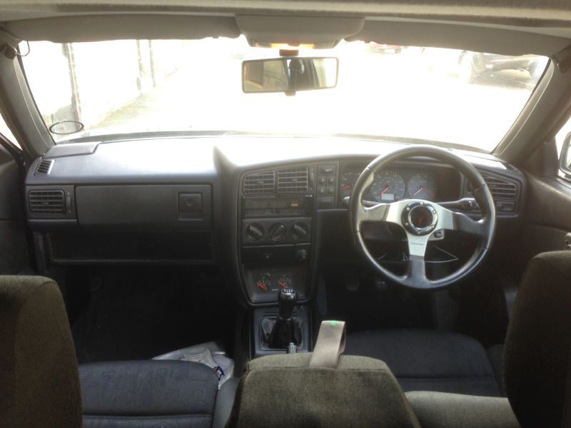

mic_VR 3 Posted October 18, 2014 Cheers guys, I know a lot of you have had the same pain... It's a corrado rite of passage! Quote Share this post Link to post Share on other sites

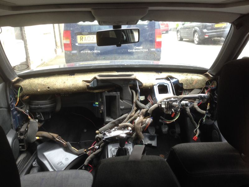

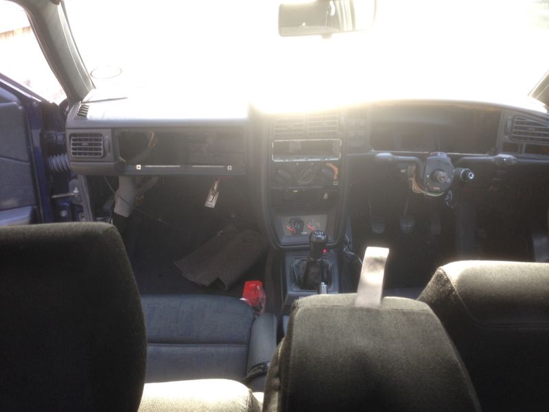

mic_VR 3 Posted October 22, 2014 So quite the productive afternoon. Start Middle End And surprisingly the foam on the directional flaps seems in good order So overall pretty successful. Could've gone further but without being able to complete the job (matrix not arrived yet) I thought I'd leave the rest until the weekend. Quote Share this post Link to post Share on other sites
