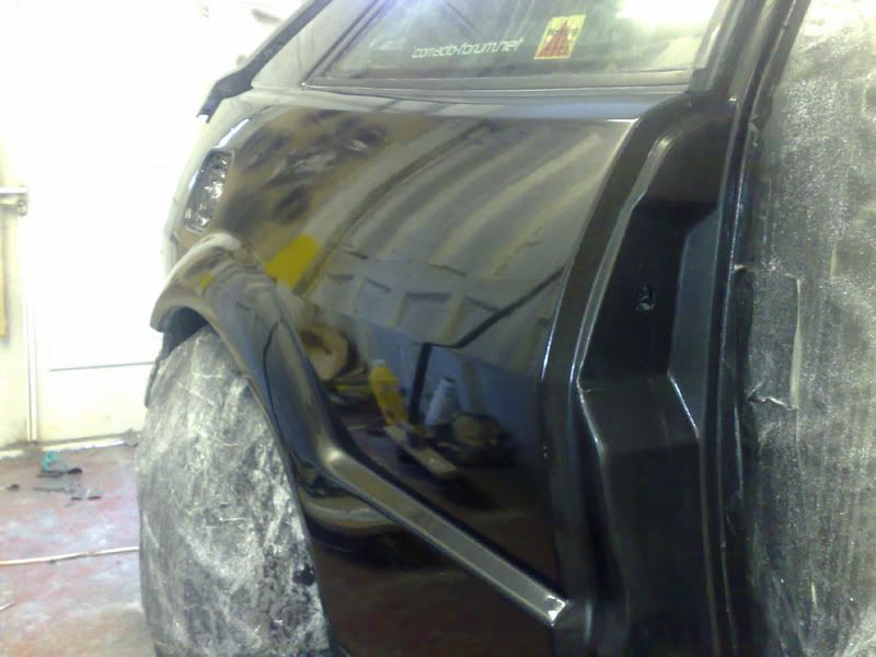

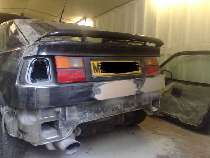

tim20vt 0 Posted September 1, 2007 (edited) i give my 16v a new coat of paint,iv been goin to do it for 2 years but the wing rusted thru so its forced me to get on with it,2 years is a bit lame if ya can do it yourself heres the progress so far,im even goin to push the boat out and paint the borbet cs i have in my garden :) Edited July 19, 2012 by tim20vt Quote Share this post Link to post Share on other sites

tim20vt 0 Posted September 2, 2007 i used to work on old beetles and campers i had so ya get used to welding and filling etc,i only debaged the rear, the smooth bumper isnt for me,just done the doors today so it shud be finished mid week,if anyones wondering why i havnt taken the glass out,you can feed cable in between the seal and body to hold the seal off so the paint will go underneath so it shudnt peel later best solution without needing autoglass etc. il take sum pics when its finished,id be more than happy to answer any questions on body stuff if it will help anyone wanting to try it,i dont paint for a job but wouldnt recomend painting 2k in ya garage without the proper gear.it could make ya ill:) Quote Share this post Link to post Share on other sites

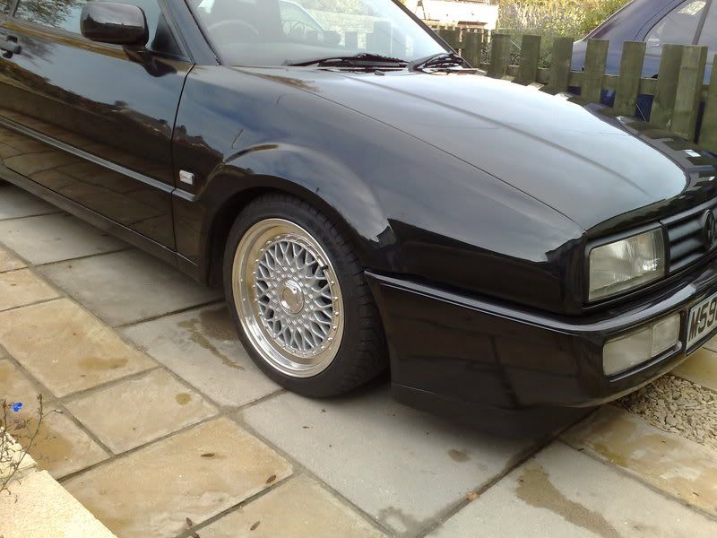

tim20vt 0 Posted October 1, 2007 got it finished and the wheels :) just need to find sum new centre caps. Quote Share this post Link to post Share on other sites

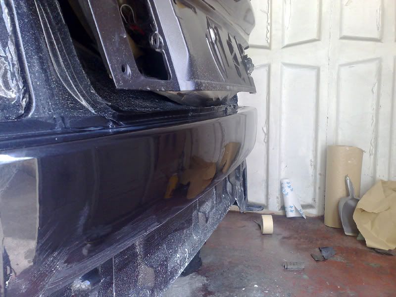

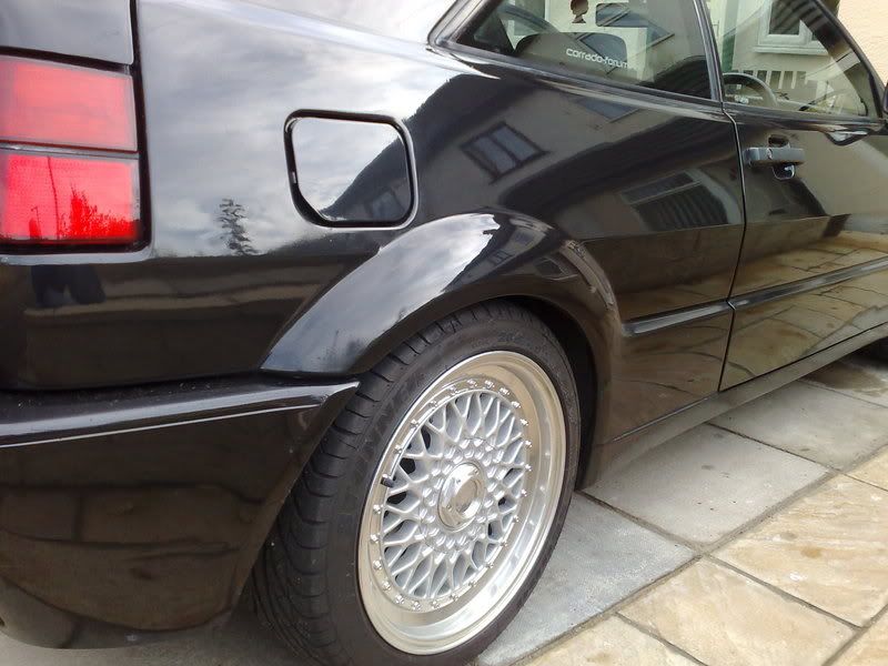

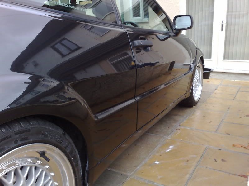

tim20vt 0 Posted October 28, 2007 started to buff it up now its hard :) turned out the borbets were bent so i had to scrap them. gray leather next,then the 1.8t :D non buffed side and the buffed one Quote Share this post Link to post Share on other sites

tim20vt 0 Posted October 28, 2007 iv just finished buffing the whole thing,worth it but after 2 days goin at it i feel dead :) now i need to buy sum hide and do my seats :) once ya start you just have to keep goin dont ya :D Quote Share this post Link to post Share on other sites
