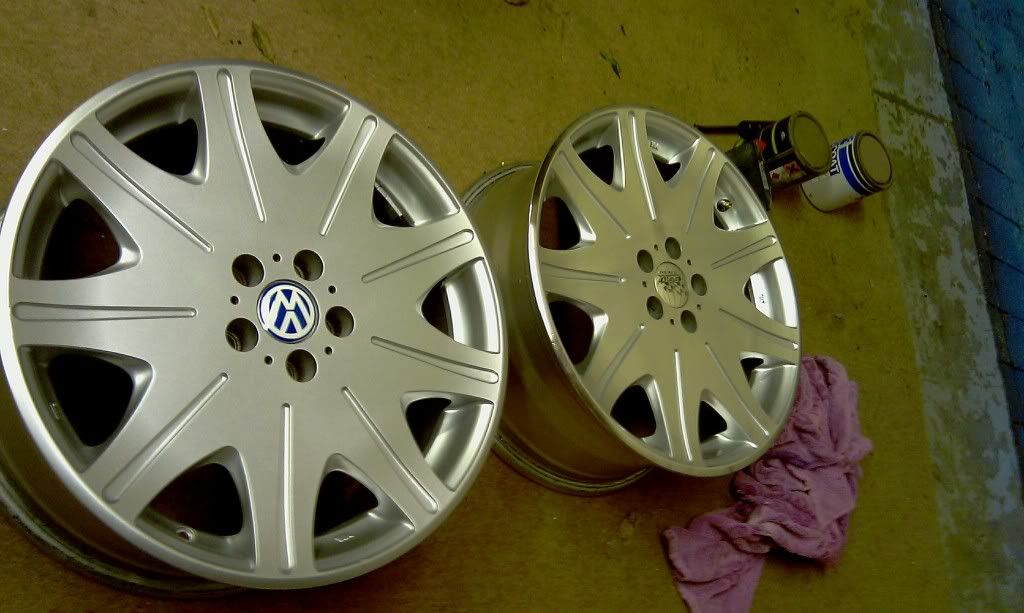

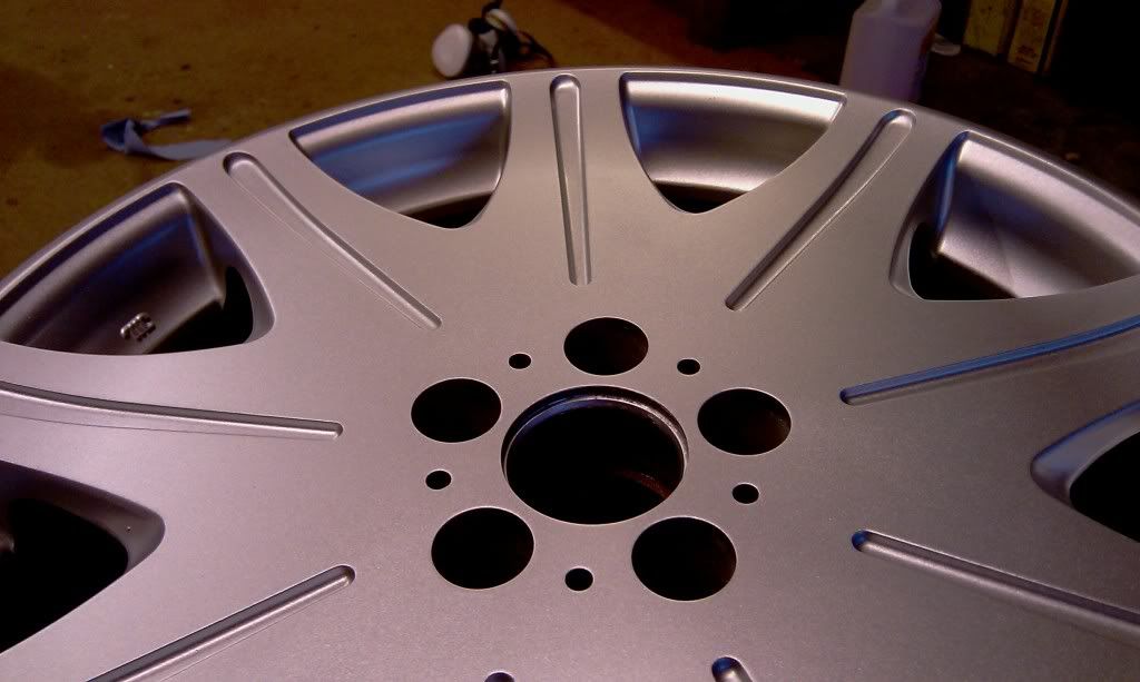

Started the wheel refurb.
I tried to turn this thread into a blog to trim it down a bit, but it looked as if it would be a very long task so i gave up! If anyone has any good tips let me know!
Few taster pics.

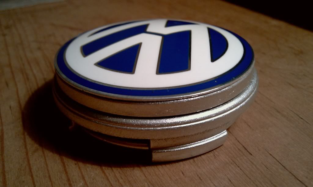

Centre caps didn't fit....
So I turned the centres out of the SSW ones, and fitted the VW one inside. They look good poking out a bit (only the vw cap sticks out -not all of it), but needed to be colour coded to the wheel to match..
Go Compare
Still have to put the clear coat on, and do the other 3 wheels!
