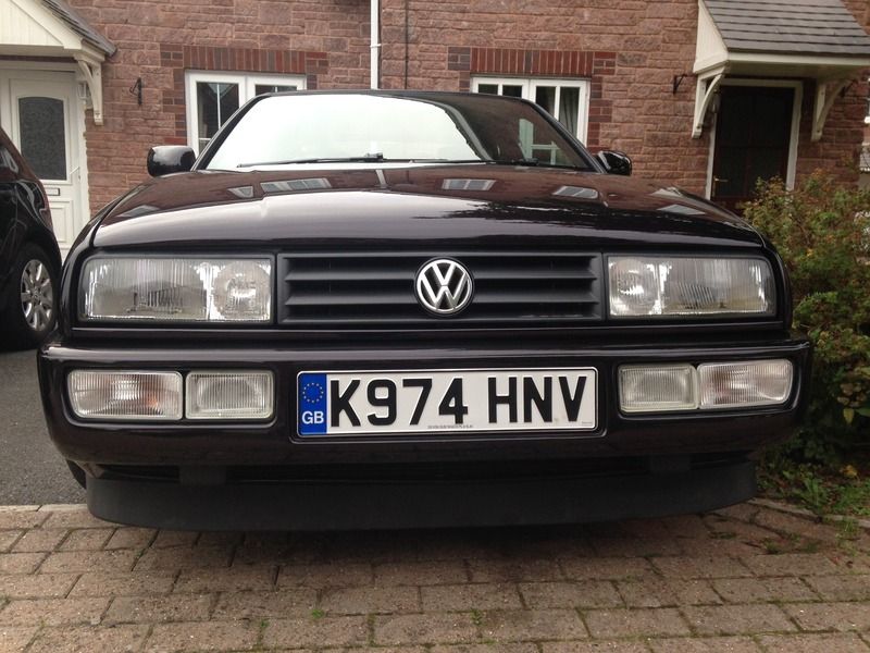

robrado974 1 Posted October 23, 2015 (edited) Thanks Sean . A pic of the new indicators , trouble is they show how bad the foglights are ! Also as said , I've had the gearbox seal renewed and the sump gasket . The oil cooler rubber seals were replaced as well . Then a good clean up of the engine while it was on the ramp . I replaced the dizzy and rotor arm too , it was looking tired and moisture had got into it . On to the next jobs now . Edited October 23, 2015 by robrado974 Quote Share this post Link to post Share on other sites

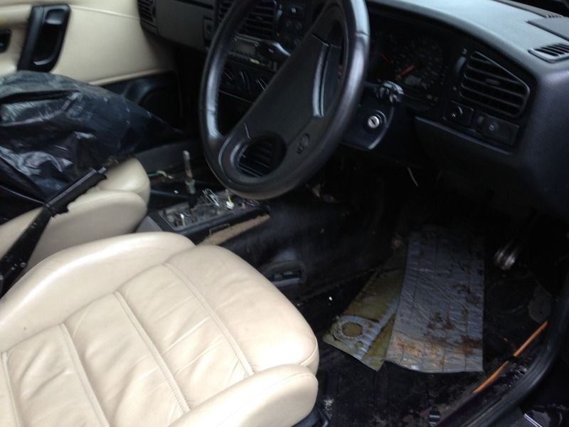

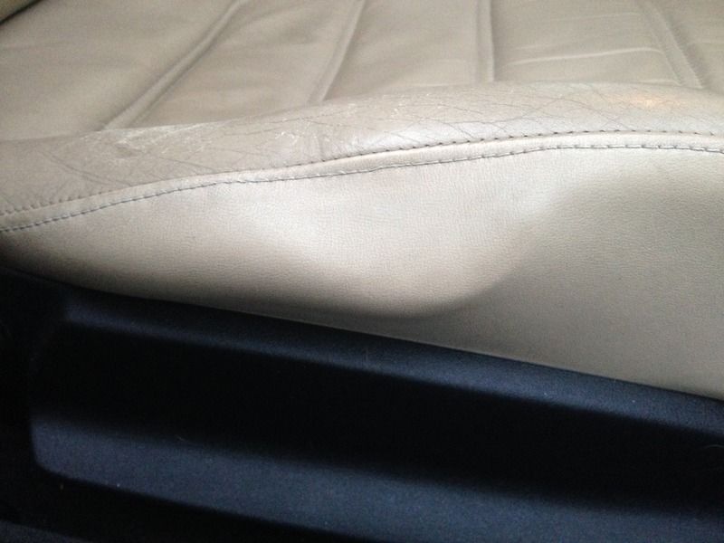

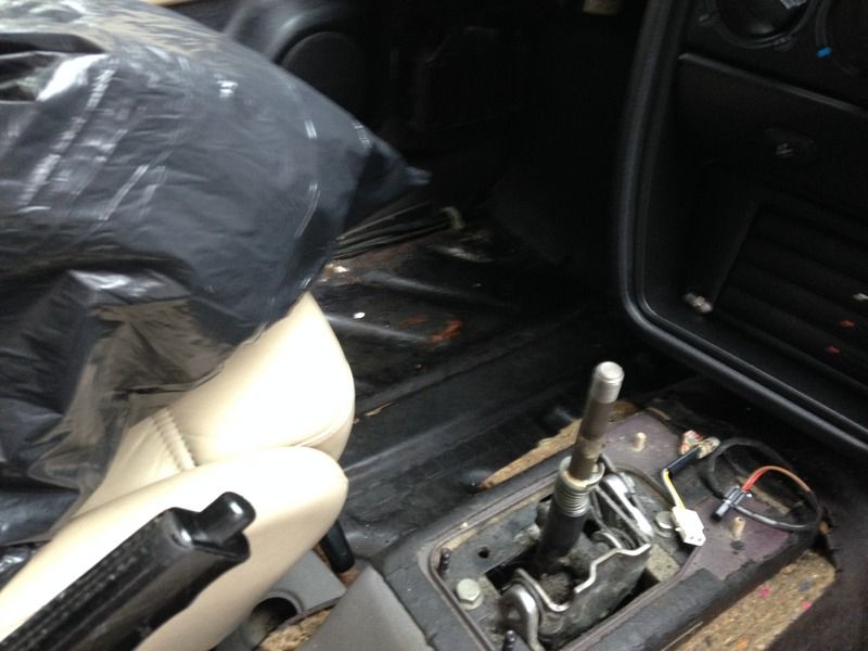

robrado974 1 Posted November 8, 2015 So today i removed the interior , well the front anyway . As said in my last posts ,i have new underlay to go down and a heated seat loom on the way so the carpets are out . The seats are in dire need of refurbing , the bolster has sunk on the drivers side . I have a working heater control set to fit as well as my directional control has broken . So i have a few hours work there . The drivers seat has been put back in so i can still drive the car . This to me is important as im not fond of removing the battery over the winter period and putting it on trickle charge and the car not moving .It needs to be driven . On removing the carpet , i accidently ripped it !!!!. I was carefully removing it from where it is stuck to the rear carpet and it tore a hole in it . So i think a new one will be ordered from Heritage .Not something i wanted to have to buy but accidents happen . The rear mat will hide the rip but i know it will niggle me . I know ive had membrane problems in the past but when i removed the nasty old sound deadening it was sweating or condensating under there . I have managed to track down a front and rear crossmember and subframe . Ive decided to refurb the rear underside first , which i have all the parts for . Then work my way to the front later on as an when i can afford to powder coat parts . A few pics from today . Quote Share this post Link to post Share on other sites

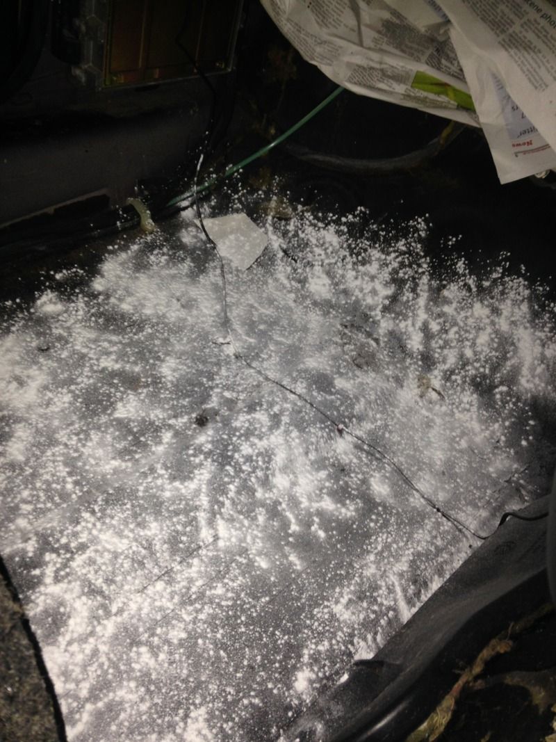

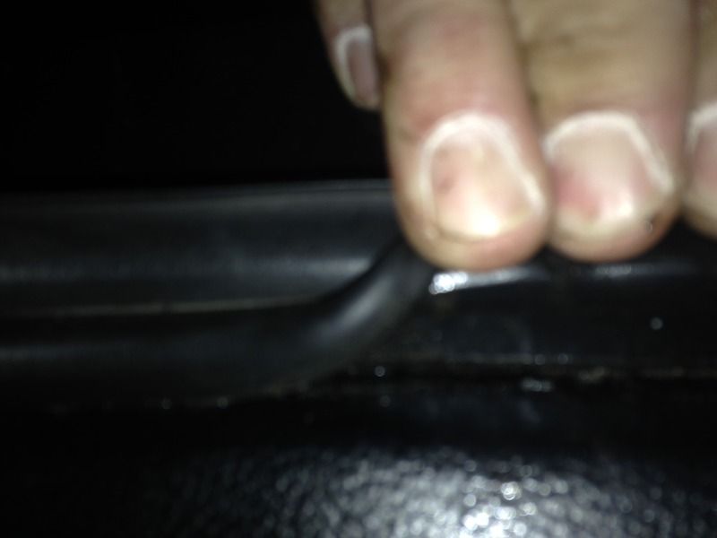

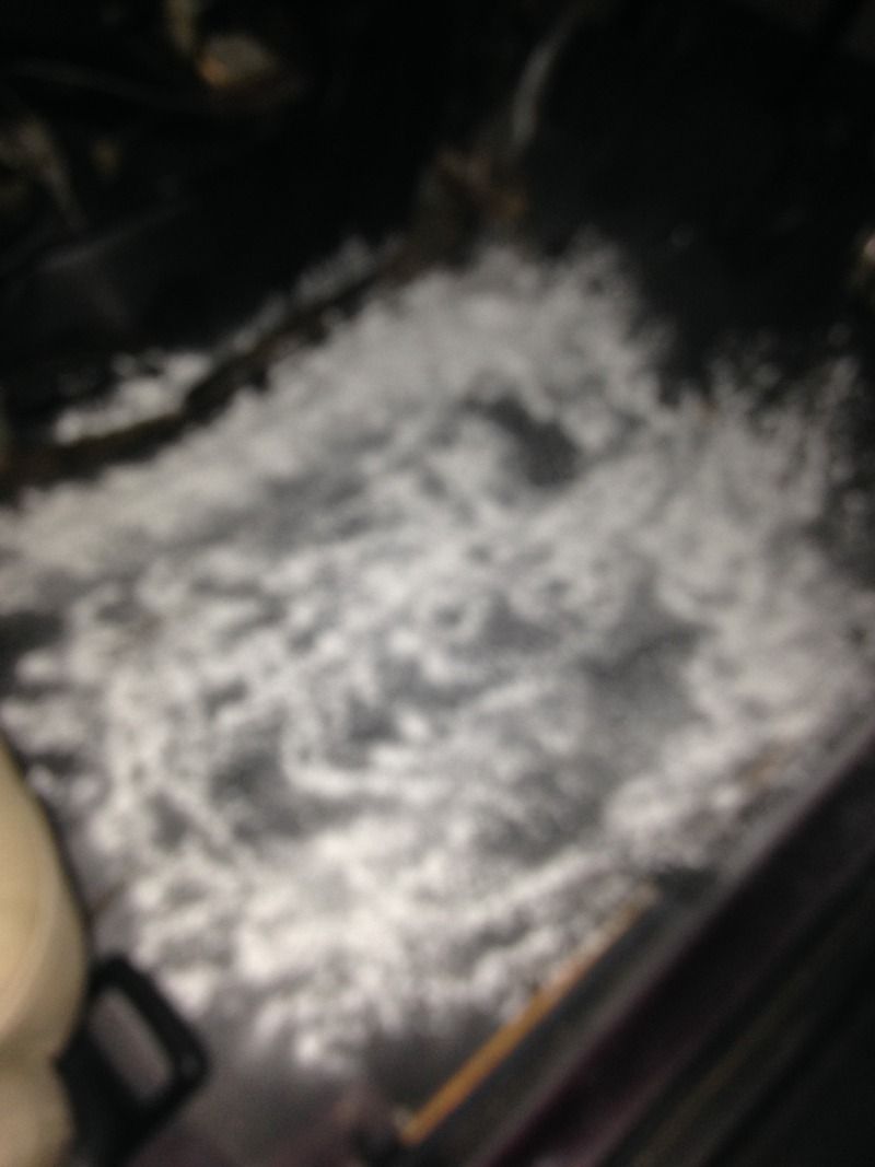

robrado974 1 Posted November 11, 2015 (edited) Well with all the sound deadening out of the car ,bar some higher stuff that is up by the pedals and a bit behind the plastic part that runs along the tunnel towards the bowden cables , i have been inspecting the car in the mornings and evenings and they has been condensation on the floor . I felt the remaining deadening and it felt dry apart from the bit along the tunnel , so i have now removed it all apart from where it goes right up behind the dash on the passenger side . Hopefully it will be dry tomorrow . It must have been wet since i had the membrane leak , even though i had a dehumidifier in there for ages . I have two bin liners covering the bottom of the screen onto the bonnet to stop the leaves getting under it , so i cant see any water getting into the foliage panel . However to be sure i have newspaper under it in the cabin which will show any tell tale drips . Both foot wells are covered in talcum powder to reveal anything as well . I also checked the boot and noticed where the seal runs along the bottom and sits next to the boot plastic , its soaked !.The lights are as tight as can be , so i presume the spoiler is leaking again . Things are not looking good at the moment !. I had already removed the spoiler and sealed around the plastic part that houses the captive nuts . What are the chances of removing them again without it breaking , i was lucky last time . If theres one thing that really bugs me ,its when you take time to do something and make sure its ok , only for it to go wrong again . So now the rear of the car is going to have to be stripped too . BUGGER!. I think the spare room is going to be over flowing with new parts and old parts i need to remove . My heated seat loom arrived this week from Vaghag Chris , so there is some good news . Edited November 11, 2015 by robrado974 Quote Share this post Link to post Share on other sites
Harrier 1 Posted November 11, 2015 'Wetness & Talcum Powder' ?! Thought I was on the wrong website for a minute ! Seriously though, water leaks can be a nightmare on these old cars, is it worth trying a car cover or something ? I think you could be trying forever to stop the water getting in. Quote Share this post Link to post Share on other sites
