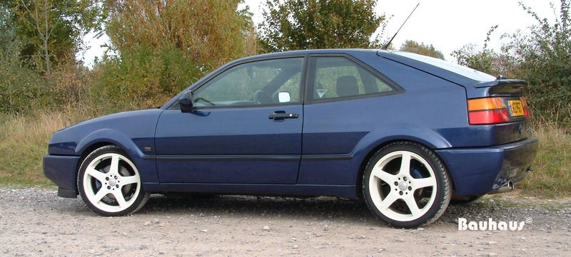

Bauhaus 3 Posted May 2, 2017 Thought it was about time I started a thread on my car which I have owned since 2004 This is how it looked back then prior to me doing any mods.. The current spec now is as follows Front Discs, Seat Ibiza cupra R 1.8 Turbo 305mm Front Calipers, Porsche Boxster 986 / 996 Brembo S Front Brake Calipers C2 Rear Discs, VW late 16v front 256mm discs. Rear Calipers, Seat Leon Cupra R 1.8 (for vented discs) OZ Polaris wheels finished in Anthracite grey Wheel Stud Conversion Front mount intercooler Audi TT wishbone rear bushes + front polyflex bushes on wishbones Bilstein B12 suspension with Meyle HD VR6 top mounts Inpro angel eye front headlamps Red/smoke rear light clusters Racelogic traction control (removed in 2016) Audi TT large wish bone bushes Polyflex small wish bone bushes Vibratec front engine mount Integrated Engineering under car surge tank with Bosch 044 fuel pump I will update this further with pics of the mods etc in the coming days... Quote Share this post Link to post Share on other sites

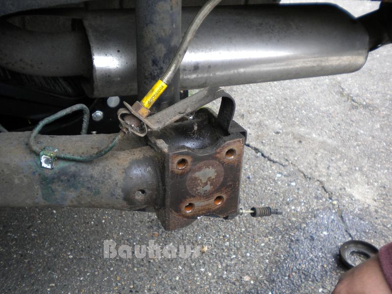

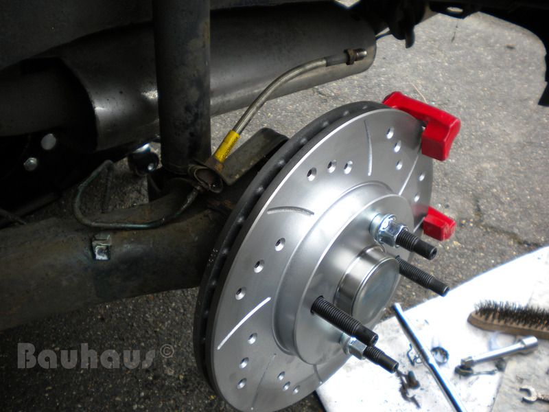

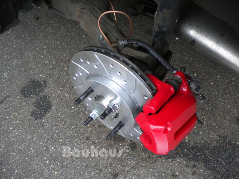

Bauhaus 3 Posted May 3, 2017 (edited) I did this as I was fed up with adjusting the bearings after every MOT when I was given either an advisory or failure on worn rear wheel bearings which weren't but just needed adjusting In short this mod eliminates the stupid taper bearing and castle nut adjustment, easier disc change, a much better handbrake and a slightly better braking performance.. the best bit its all from the VAG parts bin or euro car parts etc except I believe the Lupo caliper carrier is no longer available. Rear Brake components stripped from rear axle. Lupo back plate and Polo 9N stub axle in position. Polo 4 stud rear hub.. this was modified with a golf front ABS ring for traction control. Mk2 golf 16v 256mm front vented disc and a MK4 anniversary caliper bracket, The wheel stud conversion also on the fronts makes putting on wheels much easier. A Seat Cupra R caliper completes the conversion.This is my 4th year running like this with zero problems with passing MOT or braking performance. I'm looking into to using G60 280mm front discs with adjustable brake bias.. of course that is just purely for cosmetic reasons for filling 17in rims. Edited May 5, 2017 by Bauhaus updated info Quote Share this post Link to post Share on other sites
Thursdave 10 Posted May 4, 2017 That rear bearing change looks very interesting! Don't suppose theres a list of part numbers anywhere? Quote Share this post Link to post Share on other sites

Bauhaus 3 Posted May 5, 2017 That rear bearing change looks very interesting! Don't suppose theres a list of part numbers anywhere? I will check for the part numbers, But the stub axle I used was for a Polo 9N not 6N2, but the Hub was a Polo 6N2 Quote Share this post Link to post Share on other sites

TheWizardofOdds 0 Posted May 20, 2017 This is my favourite corrado colour by far and they're as rare as hens teeth in Inca Blue. Could you post more pics of the car please? Quote Share this post Link to post Share on other sites

Yandards 0 Posted May 21, 2017 Rear axle swap info can be found on Club GTi forum but you will need to register if you haven't already. Polo double roller bearing rear axle fit As for front brakes there isn't much reason 280mm discs won't fit under 15" wheels you just need to make sure the offset works with the disc to caliper and carrier clearance - although you will then have a hugely over braked rear axle.. Quote Share this post Link to post Share on other sites
Bauhaus 3 Posted May 22, 2017 This is my favourite corrado colour by far and they're as rare as hens teeth in Inca Blue. Could you post more pics of the car please? Great car. Have you any interior and engine shots? Thanks for the comments, I heard that Inca blue is rare, not sure how many there is about ? Having a few issues with photofuc*it hosting my photos, so I'm direct posting here a few more pics of my car from last year on the ramps at Tyre Smart in Witham,Essex when it was having a full wheel alignment done, the outside looks fairly standard apart from the OZ wheels, front lights and rear the lenses. The car is currently on a sorn for this month while trying to sort out a couple of electrical issues causing the car to cut out, and also to sort out a boost leak :( Quote Share this post Link to post Share on other sites
