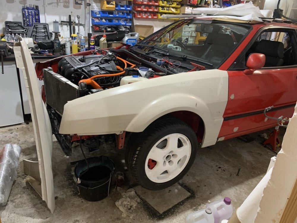

easypops 8 Posted October 13, 2020 Tried a wee test fit of the fibreglass wings, they will need a little fettling but not much, Iβll need to clear the chassis of the old sealant used to bond the original wings in I think but itβs difficult when you canβt get the doors open properly........looks like Iβll need to get it out of the garage π Quote Share this post Link to post Share on other sites

Keyo 47 Posted October 13, 2020 They look good from where i'm sitting the line comes through spot on from the door . Help with nose heavy VR as well .Β Β Quote Share this post Link to post Share on other sites
seanl82 23 Posted October 13, 2020 29 minutes ago, Keyo said: They look good from where i'm sitting the line comes through spot on from the door . Help with nose heavy VR as well .Β Β The wings don't weigh a huge amount in fairness. Bonnet, tailgate and doors on the other hand! π³ Quote Share this post Link to post Share on other sites
