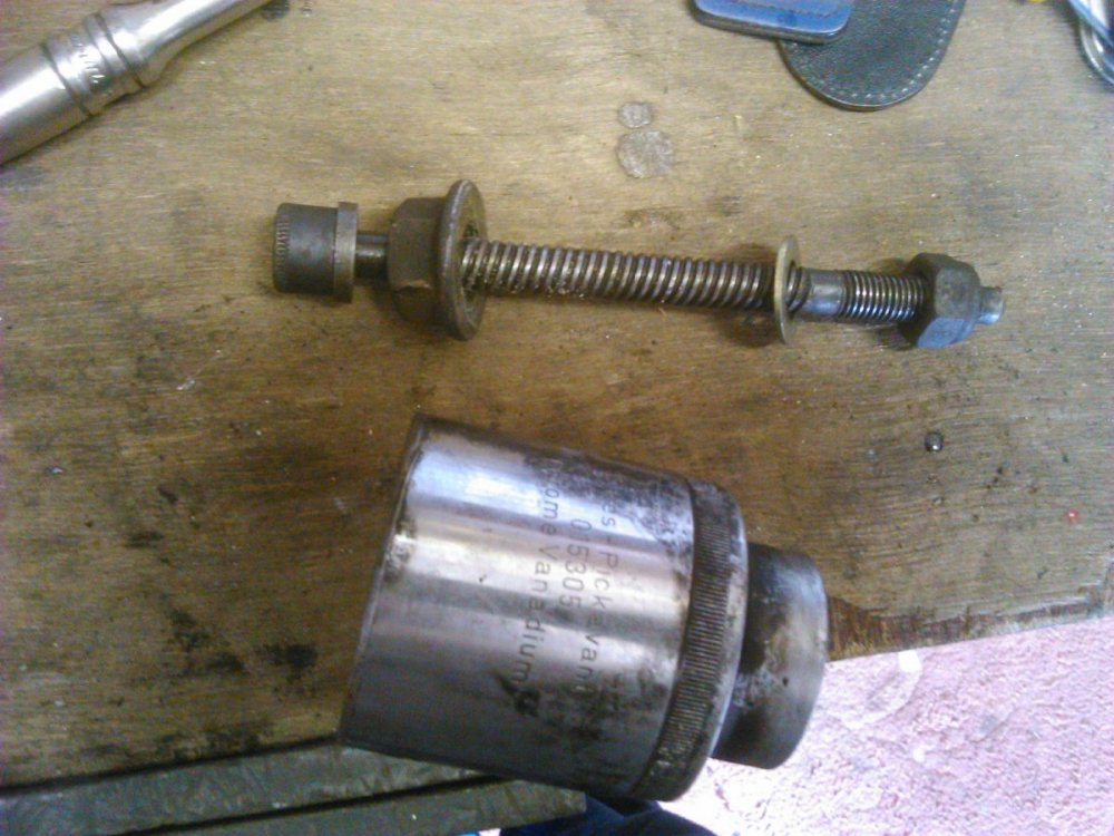

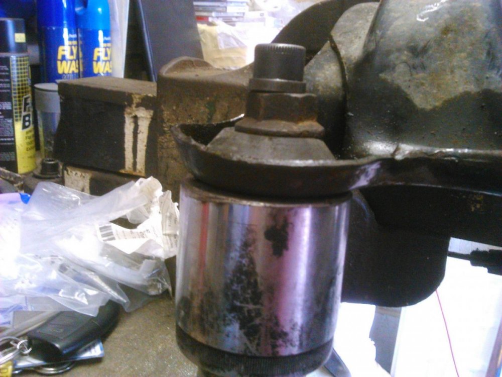

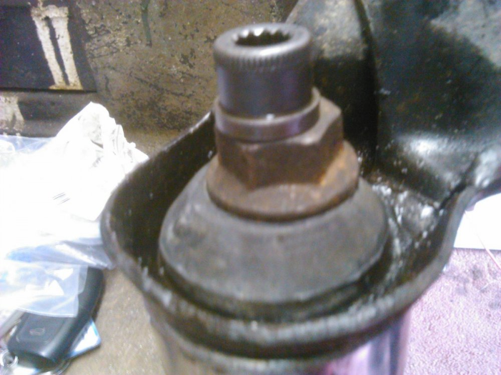

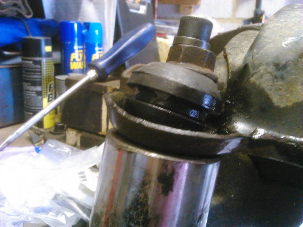

vw rule 19 Posted December 19, 2020 On 12/19/2020 at 6:30 PM, oneohtwo said: If anyone has done this with the original rubber ones (or any!) how did you get them in?! All I read about it is that it's an absolute arse - been trying to compress them, or pull them with a bolt in but no luck. It either slips to one side and so won't go in, or, if it is lined up straight, because the tapered end is bigger than the hole it just sits around the outside getting bigger the more it compresses. Plenty silicon lubricant applied but still nothing. Hello there, I did mine a few years ago and used an old cylinder head bolt I had laying around, plus a couple of large washers, a nut, and a very large socket to spread the weight but mainly to pull the old bushes into. The new OEM bushes I sprayed a little with WD40 and small amount of EP grease, and they pulled into place without any real hassle. The only other thing I used to assist me was a medium sized flat ended screw driver, simply to aid fitment by pushing slightly on the side that was starting to tilt, that's about it really. Photos below when I fitted mine. Hope this helps Si Quote Share this post Link to post Share on other sites

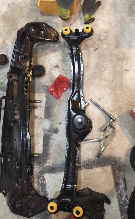

easypops 8 Posted September 7, 2021 I replaced the originals for the poly ones. I copied the way the original ones were, so fairly confident I’ve got it right………. Unless the originals were upside down, but I doubt it Quote Share this post Link to post Share on other sites

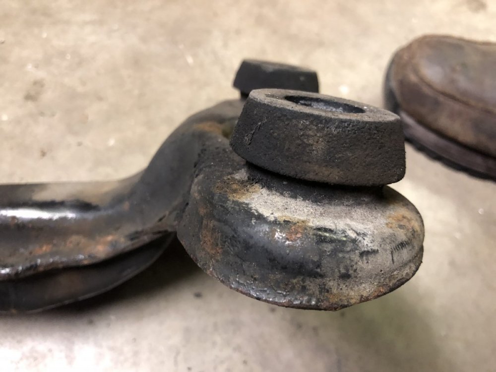

1xshaunx1 27 Posted September 12, 2021 On 9/2/2021 at 2:28 PM, fla said: just to bring this one up again, which way round do they go? I assume the tapered part is inside the cross member? Or are they the same both ways? Planning to do mine some time soon... Edit: just checked my spare set in the garage and they're not directional This is a shot of original figment. Quote Share this post Link to post Share on other sites
