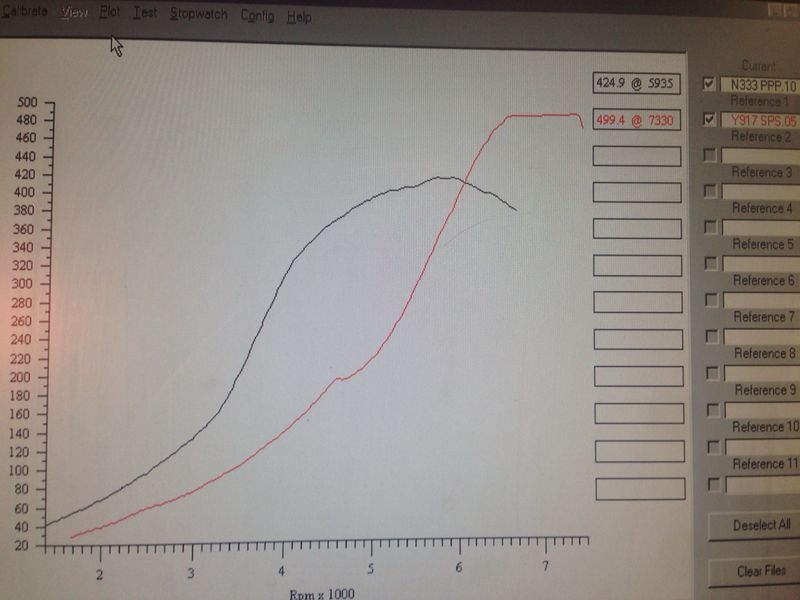

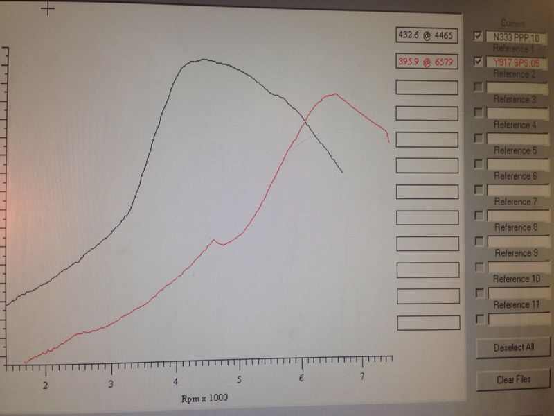

fla 9 Posted February 20, 2014 n3p said: You're telling me! Now i'm really worried about the gearbox! Vince also sent a comparison against a 500bhp big turbo Audi S3 (in red)... bhp: torque: ...insane! So this means you would destroy the Audi up to around 5000 rpm, with, I assume a significnat weight advantage, so perhaps totally leave it for dust? Quote Share this post Link to post Share on other sites

coullstar 0 Posted February 21, 2014 (edited) You would kick its ass on the road. Its area under graph that you want, you have loads more. Just shows that focusing on numbers is not the whole story. Your car makes way more power and torque up until 6krpm, how many times do you get that high on the road and by that time you will have fooked of out of sight. For example this is another good torque curve. Boosted V6's are the bollocks, hell even F1 have them now...... Edited February 21, 2014 by coullstar Quote Share this post Link to post Share on other sites

MarkFoster 0 Posted February 22, 2014 By the look of the graphs, I reckon you'll be back for the Race Logic setup fairly soon... Quote Share this post Link to post Share on other sites
