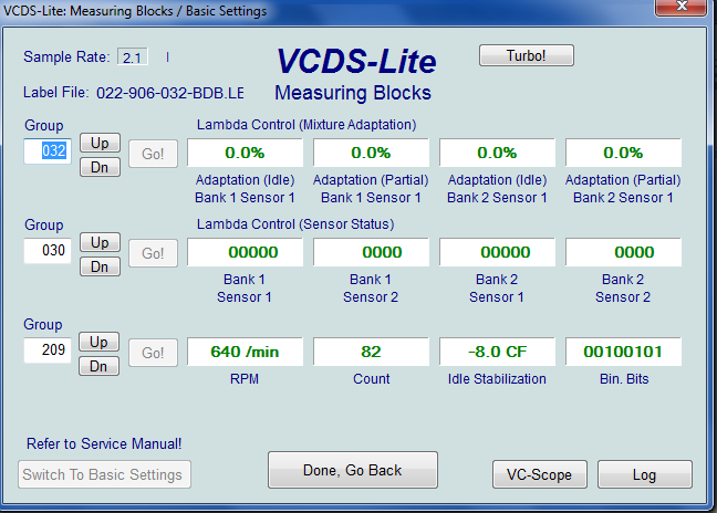

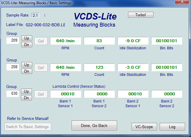

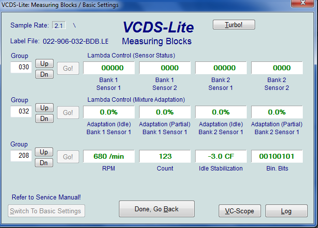

Well this thing is starting to really get on my nerves, it absolutely stinks of fuel... I could pretty much catch the fuel out the exhaust and just throw it back into the fuel tank.
Couple of things I really really didn't want to see... correct me if I'm wrong but that looks like chain stretch? And appears to be staying in open loop, connected up the rear lambdas and tucked them away, reset error codes let it idle up to temp and no lambda adaption. VAGCOM logs and error codes below, strangely enough I do have the SAI relay wired up.

I'd be concerned about the reading in block 209 regarding the chains, which could cause a timing issue to cause the high HC?

What engine is it? Blocks 209 & 208 should read in KW (german for degrees). Not sure what 'CF' is. Not seen that before. If block 209 really is at -9, it's either not timed properly or has chain stretch.

Its an Audi A3 3.2, fairly sure its exactly the same as what you had Kev. I'm a bit stuck with what to do, what triggers closed loop, is it just blue temp sensor (R32's version). The ECU does seem to read water temp, I'm going to try run it up to temperature again tonight but it does seem like the lambdas are just not showing any values in the ECU at all, MAF readings seem about right (compared with what I've seen on forums)
Not sure it'll help but my 24v wasn't reading any lambda values due to other faults within the ECU (MAF, SAI etc). As soon as I got those faults cleared (by Vince) the lambdas began reading and adapting correctly.

+2. I notice the N80 evap valve isn't connected as well. Without SAI, N80, rear lambdas etc connected or coded out, it won't run properly. When all is well, closed loop will run not long after start-up and you will see some adjustment values in the measuring blocks. Because of all the faults, it's assuming a complete meltdown and is running a very basic map to get you home.
Next step is to get it up to Vince. -9 deg is on the ragged edge as -8 is the limit. Yours hasn't thrown the "Cam / crankshaft correlation error" yet, so you're within limits, just. I reckon yours is on the change over year when VW introduced upgraded chain gear, so yours might have the older MK4 stuff.
