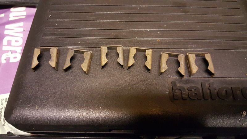

Jim Bowen 1 Posted September 16, 2015 Bummer. Just found these. They are the clips for the fuel injectors. Seems i forgot to fit them. So going to have to remove a few things. Oh well. Should be glad i noticed them now i guess. Quote Share this post Link to post Share on other sites
ChrisL 20 Posted September 16, 2015 Bummer indeed, but on the other hand the cars looking great! Well done. Quote Share this post Link to post Share on other sites
1xshaunx1 27 Posted September 17, 2015 I bet you used some choice words when it clicked/noticed them. You've got to laugh though, Quote Share this post Link to post Share on other sites
Philuk 0 Posted September 18, 2015 Buggar! That's a turd ain't it! What condition are they in? VW still sel them brand new and iirc they were about a pound each, mine were all rusted Quote Share this post Link to post Share on other sites

fendervg 33 Posted September 18, 2015 What's the deal with the injector clips? Do they need to be replaced? Was it easy to get the old injectors out without losing bits of the seals, and then putting the new ones back in? sorry about all the questions - just looking to do this myself soon as I now have my refurbed injectors back from Mr Injector. Great service by the way. Quote Share this post Link to post Share on other sites
Jim Bowen 1 Posted September 18, 2015 Quite hard to pull out the rail and then pull out injectors as well, i didn't damage anything doing mine though. Think i used some WD40 onto the seals first. Almost seemed too easy to push back in, i am hoping they are sealed ok :lol: Not sure if mr injectors o-rings were slightly smaller O.D or if when i cleaned up the holes on fuel rail and inlet i over did it and made them slightly larger. Got the clips fitted last night and everything back together. Wasn't too bad a job. Quote Share this post Link to post Share on other sites
seanl82 23 Posted September 18, 2015 When I did mine, they were a pig to remove and replace, but the old seals came out perfectly intact. I think the refirb set you get from Mr Injector come with new seals anyway, but if not they're about £6 each from VW! Just be very gentle when refitting them and use some lube on the seals, as I forced one and broke the brown plastic bit surrounding the jet, which subsequently fell into the head! Luckily my engine was out and on a stand, so I tipped it upside down and it all came out. (It snapped in 2 and was a clean break luckily). I also had a spare set of injectors that I'd ultrasonically cleaned and refirbed myself so I got off relatively lightly. Quote Share this post Link to post Share on other sites
