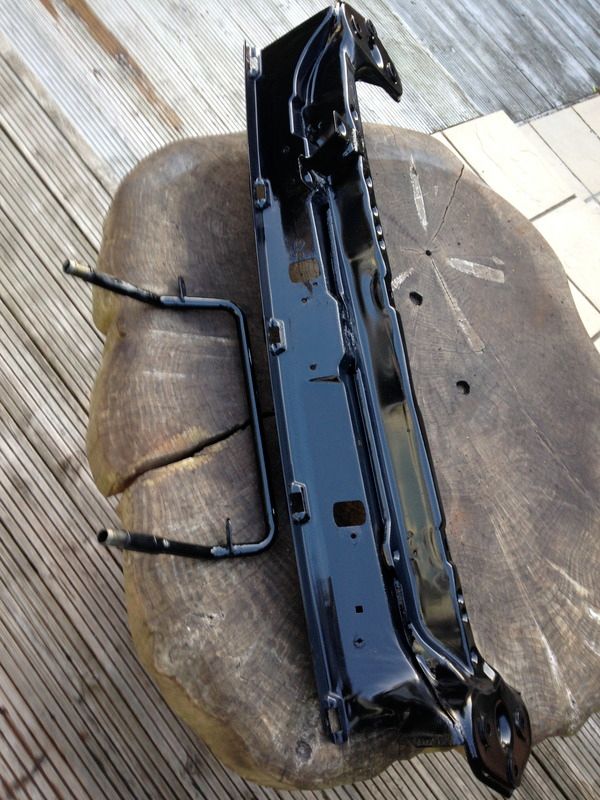

robrado974 1 Posted September 2, 2015 Been fettling with the car over the past few weeks . Thanks to Chris i have a great condition set of plastics to fit round the rear screen with no broken tabs . Ive fitted them all apart from the main cover as i have a leak from the spoiler seal. I managed to remove the top screws without damaging the bolts , put a silicone seal on the cover plate and screwed it back in place , hopefully this will stop the leak .Ive also had the filler cap seal off and cleaned out the drain hole , while it was off i removed all the crusty bits from the area. I bought a second hand radiator support a while back . This has been degreased rubbed down and prepped, i then sprayed it with five coats of hammerite , its come up really well . I will put a pic up later on . So the under side part collection is coming on , i still need front wheel bearings , the clips that hold the cables to the rear beam , abs rings , engine mounts and and maybe the cross member . As usual the main problem is time, money and a dry place to work , that and somewhere to store other larger parts that have to be removed. To fit everything on the underneath is going to cost me £280.00 which is not to bad considering this is two days wages for a mechanic and a ramp , i will be helping on a saturday and the rest will be finished on a monday , thats the plan anyway . Onto the paintwork .....dear oh dear its not looking good . I have small rust patches on various parts of the car , i can see a respray on the cards in the future .All in all i suppose its par for the course of owning a 25 year old car .I think if im honest I'm not happy at all with the car at the moment , it seems like one step forward , two steps back .The cover is on the car and ive walked away from it for a while . Depending on the weather i will be meeting up with Rog next wednesday for a mini meet of retro cars . Hopefully this might restore a bit of love !. Quote Share this post Link to post Share on other sites

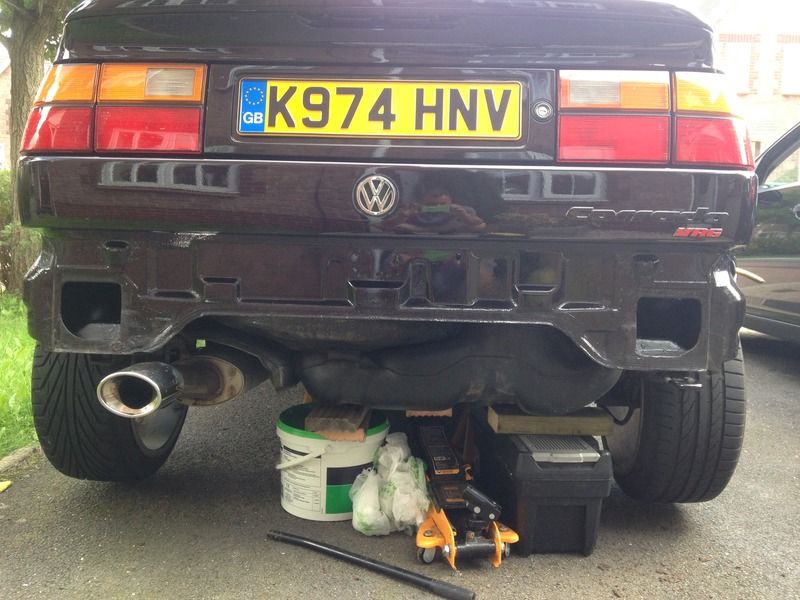

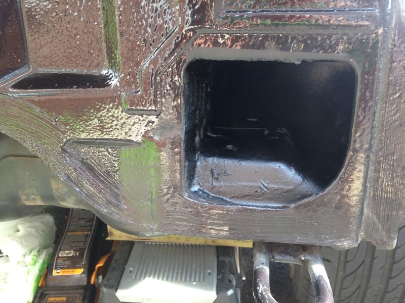

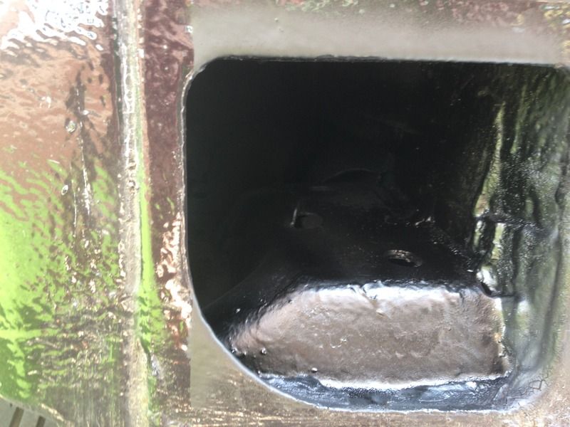

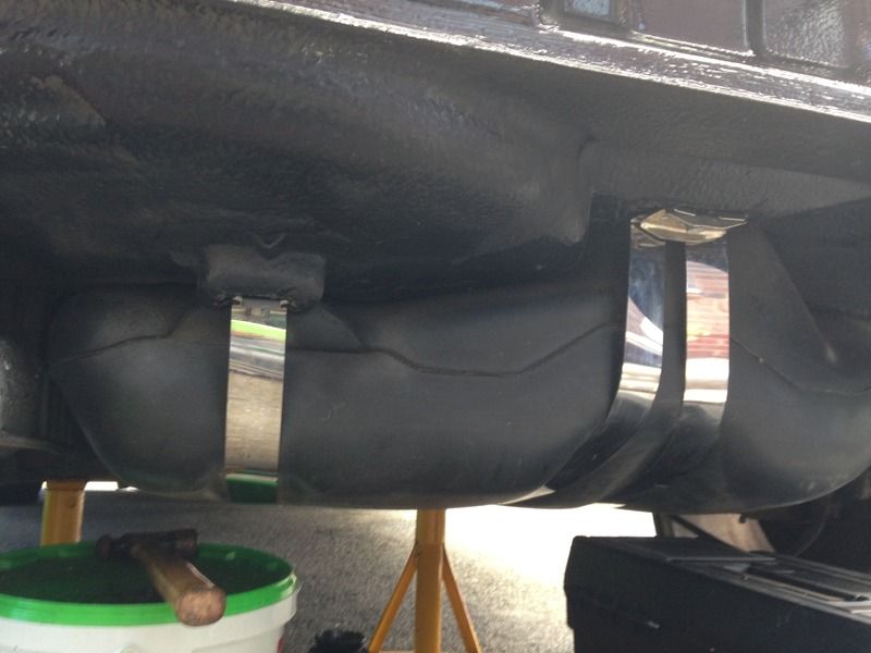

robrado974 1 Posted September 13, 2015 Well its the end of the summer , not that i drove the car much anyway. Ive come to a decision to take the car off the road and start replacing parts that are long over due . The problem ive always had is i never want to not be able to drive it !. Once you start a big job , your into it and thats that , you cant wake up on a bright sunday morning and jump in for a drive . But after seeing so many refurbs going on on here ,which are great inspiration , i thought no , thats it take it off the road and finish the car . It will be done in stages and not all at once ,like most of us im not made of money . So the underside is the first job to tackle . With the rear bumper removed , i was pleasantly surprised at the condition of the car . Bar a few cobwebs its A1 . Armed with a screwdriver and a hoover i scraped the inside of where the bumper irons sit and removed a small amount of dirt and hoovered it out , i then cleaned it . I then masked the outside areas and sprayed underseal into the hole . Its all nicely sealed in there now . I have also supported the petrol tank and removed the straps . I purchased the stainless steel set of straps, Five new bolts and the bracket from Ebay , so it all should be back on by next sunday . Not much but its a start . Just need those last few parts so i have everything to replace underneath . Just some pics of the work so far . Although i sent the rear beam to be dipped , blasted and powder coated , i could not afford to send the rad support , so i stripped it my self and gave it five coats of Hammerite . I think the pics speak for themselves I'm very pleased with the finish . So the next stage is more saving for the last bits . I ripped everything from the shed , all the new parts and refurbed bits , its now under the bed in the spare room and the wardrobe is full , you could not move in the shed for parts ! , its amazing what you collect in eight years and forget about . Quote Share this post Link to post Share on other sites

lilfuzzer 1 Posted September 14, 2015 Looking good rob Rad support amd power steering pipe have come up really well Quote Share this post Link to post Share on other sites

Jim Bowen 1 Posted September 14, 2015 Nice one Rob, I will be following this. Rad support looks great. Quote Share this post Link to post Share on other sites
